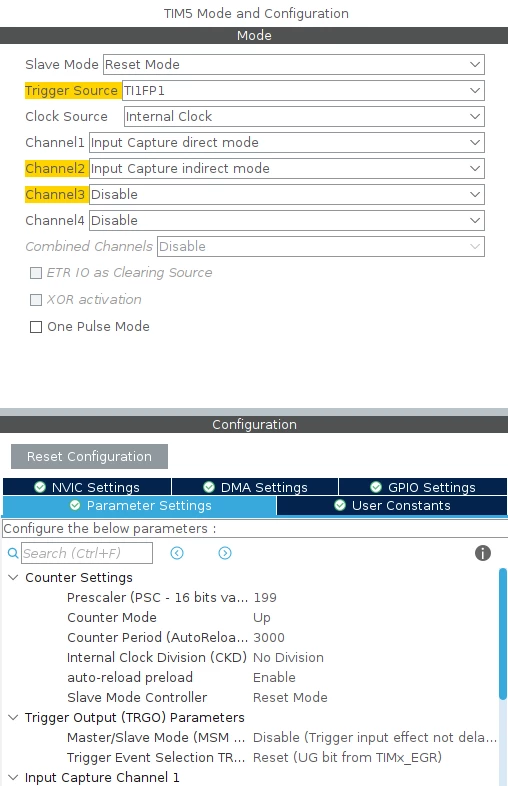

However I'm now looking at match mode and am not quite certain how to set this up... I've set it up to use CH1 for input capture, rising edge (as you pictured), and CH2 is indirect, but where and how do I calculate the pulsewidth?
I was assuming CH1 rising edge would reset the timer, and CH2 falling edge would allow me to read the timer value. That makes sense, but I don't see how to accomplish that using the setup you've shown me... what exactly am I doing in the interrupt? And am I still using void HAL_TIM_IC_CaptureCallback(TIM_HandleTypeDef* htim)?

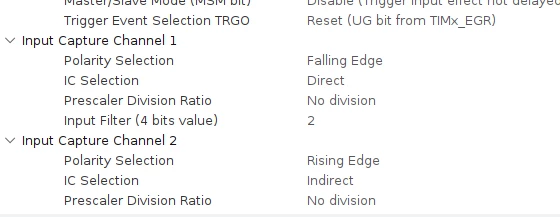

AScha.3
April 2, 2023
ok, i show you, how it is to set (i needed about 4 hours to find out...)
0693W00000bhM9nQAE.pngthen you get: - in INT -
void TIM5_IRQHandler(void)
 /* USER CODE BEGIN TIM5_IRQn 0 */
	static uint16_t pnr, cmdnr, IRpuls[15],IRcmd[5];
	uint16_t val=TIM5->CCR2;							// get puls in microsec. (3000us max. timer ARR )
ccr2 is puls hi-time in us ; timer clk is divided to 1 MHz, so 1 tick = 1 us;
timer ARR is max. time, 3000 us here, to avoid too long captures on error spikes.
