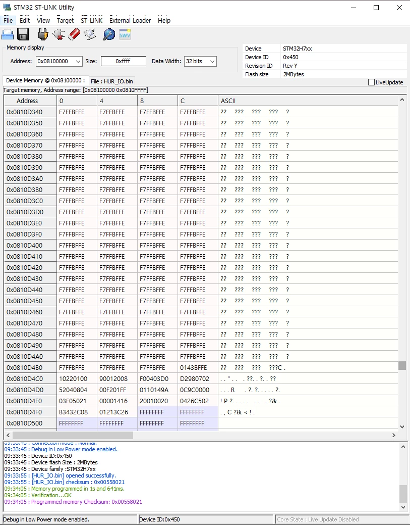

I downloaded the code to STM32H753 and then used STM32 Community to look at the data on the flash memory and suddenly I got one question.
I downloaded my code on flash memory bank 2 sector 0 (address 0x08100000) and found that the data value was written on the area that is supposed to be the last part of the code I downloaded.
The constant area was filled with 0xF7FFBFFE before the data appeared

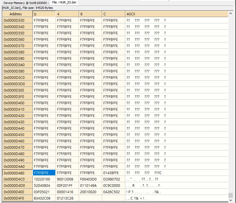

This was also found in the source code .bin file I downloaded
What do these data mean?

Your project, check the .MAP file
Beyond the CODE/TEXT section is usually the BSS/STATIC section which copies into RAM every time you start. This would be initialized data in global variables, arrays, bitmaps, etc.

If you don't mind, may I ask you one more question?
I didn’t download it when I downloaded it with IAR, so I checked it out, and there were cases where data was not written down in this area. Can you tell why this is happening?

No idea, STM32 Cube Programmer is going to write whatever is in the .BIN file.
The .BIN is 0xD4F8 bytes in size, neither screen shot seems to exceed that, so not exactly sure what behaviour you're flagging here.
Review how you're generating the .BIN file if the content is not what you expect.
The static area might be compressed, not sure about IAR, but KEIL does, and the startup code unpacks it.
