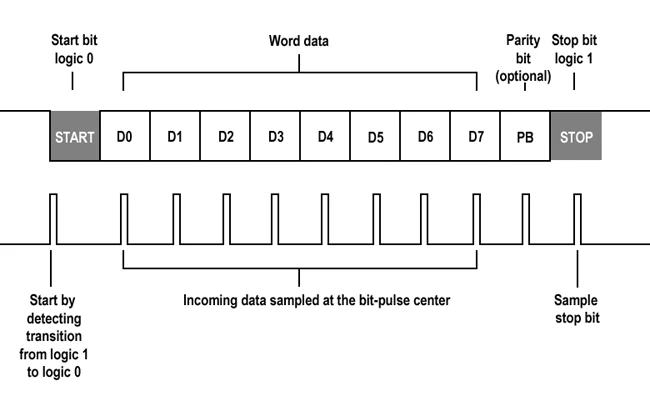

Tesla DeLorean
Tesla DeLoreanBest answer
Guru
June 15, 2022
The parity is the last bit sent, followed by the STOP bits, which provided for an intersymbol gap
In STM32 peripherals, the parity is counted as a bit, so 8E1 would be 9-Bit Including Parity
Line normally HIGH
START BIT (LOW)
BIT 0
BIT 1
BIT 2
BIT 3
BIT 4
BIT 5
BIT 6
BIT 7
PARITY BIT (making HIGH bit counts in total ODD or EVEN)
STOP BIT(S) (HIGH)
Line Continues Normally High, or you see the NEXT Start Bit

Paul1
Senior III
June 15, 2022
Not quite...
Data Length? 8bit, 7bit, 6bit...
Parity: None, Odd, Even
Stop bits: 1 or 2 (Receiver should work with either, this setting should only affect Tx, but some MCUs have trouble with 2 stop bits, i.e. some PIC32)
Notation: 9600,8N1 = 9600bps, 8 data bits, No parity, 1 stop bit
Examples:
s=Low Start Bit
S=High Stop Bit
P=Parity
B=DataBits
Len=Length of Tx (Tx=Transmit, Rx=Receive)
Set Len Example Consecutive
8N1 10 sBBBBBBBBS sBBBBBBBBSsBBBBBBBBS
8E2 12 sBBBBBBBBPSS sBBBBBBBBPSSsBBBBBBBBPSS
7N1 9 sBBBBBBBS sBBBBBBBSsBBBBBBBS
7O1 10 sBBBBBBBPS sBBBBBBBPSsBBBBBBBPS
5N1 7 sBBBBBS sBBBBBSsBBBBBS

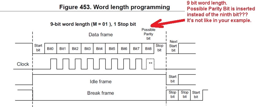

MMust.5
MMust.5Author
Senior
June 16, 2022
This picture contradicts what you wrote, as it seems to me.
Here the Possible Parity Bit is inserted in place of the ninth bit of the transmitted data?
In your example, the Possible Parity Bit is inserted AFTER the ninth bit of the transmitted data.
8E2sBBBBBBBBPSS
I took 8 bit mods as an example. In your example, there was no 9 bit mod.
Paul1
Senior III
June 16, 2022
Sorry, but ST seems to describe UART Data/Parity different from every other MCU I've ever worked with.
Life is fun.
I'd call your Diagram 8 Data + Parity, So 8E1 or 8O1.
ST would call it 9 bits with last bit as Parity (Still 8E1 in the notation I've been exposed to, since is effectively 8 data + Parity, as parity bit isn't useable to transfer data information, Parity is part of error detection not data).
