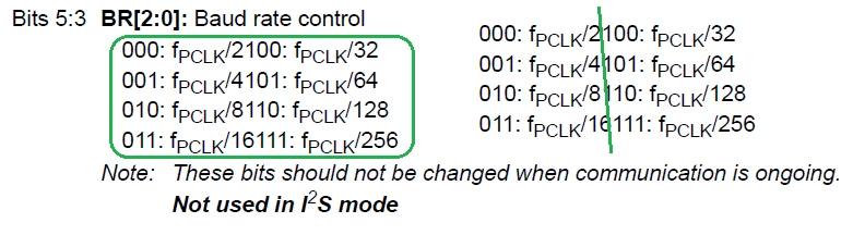

    do you know why the reference manual shows 2 values of clock divider for each setting of the baud rate control register on page 715 of the reference manual RM0038?
    I'm look at RM0038 Rev 7, which figure/table is that?
    george239955_st
    April 16, 2013
    Posted on April 16, 2013 at 17:31
    27.5.1 page 744 on rev 7
    Tesla DeLorean
    Guru
    April 16, 2013
    Posted on April 16, 2013 at 17:58
    PDF sucks
    000: fPCLK/2
    100: fPCLK/32
    001: fPCLK/4
    101: fPCLK/64
    010: fPCLK/8
    110: fPCLK/128
    011: fPCLK/16
    111: fPCLK/256
    george239955_st
    April 16, 2013
    Posted on April 16, 2013 at 18:08
    thanks dude!
