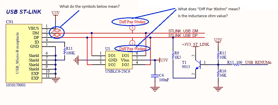

What do the following symbols mean in the NUCLEO-F429ZI circuit diagram?
This is a part of the circuit diagram of NUCLEO-F429ZI.
What do the symbols in the picture below mean? is the inductance ohm value?
thank you.

As @Tesla DeLorean said, "Diff Pair 90-ohm" means a differential pair with a characteristic impedance of 90 ohms.
With high-speed signals like USB, PCB traces need to be treated as transmission lines.
Take a look at this article:
https://circuitdigest.com/article/understanding-impedance-matching-in-pcb-design-with-example-and-calculation
No - inductance would be in henries: https://en.wikipedia.org/wiki/Henry_(unit)

Traces routed as a differential pair with matching length and impedence?
So together, side by side, same length, direct.

Differential pairs are defined by how the signal is represented electrically (as the difference of two signals), not by how you lay out the traces.
You can keep the differential pair uncoupled (far apart) and route each as a single-ended line. The "odd impedance" is then zero which means the differential impedance is simply twice the characteristic impedance of each. You can maintain a constant differential impedance by controlling the impedance of each of each separatly, as you would with a single-ended signal.
In that case, you can absolutely route each on opposite sides of the board. As long as the differential signal wherete they converge at the receiver is not corrupted, it will work just fine. They are usually routed together for convenience and to simplify delay-matching when it is required. But this is not strictly necessary. Even if they are very far apart, they can still be a differential pair.

To the original question: these are markers / directives from schematics to PCB layout in Altium Designer.
actually, that's not quite correct. 90-ohm is the nominal Differential Impedance for the diff pair that carries data in USB 2.0 (The DP/DM signals). You sometimes also encounter the equivalent term "Differential Characteristic Impedance". But the term "characteristic impedance" is usually applied only to a single-ended line (a single transmission line).
Here they placed the diff impedance annotation twice, once for each half of the pair. That's not a good way to do it.
