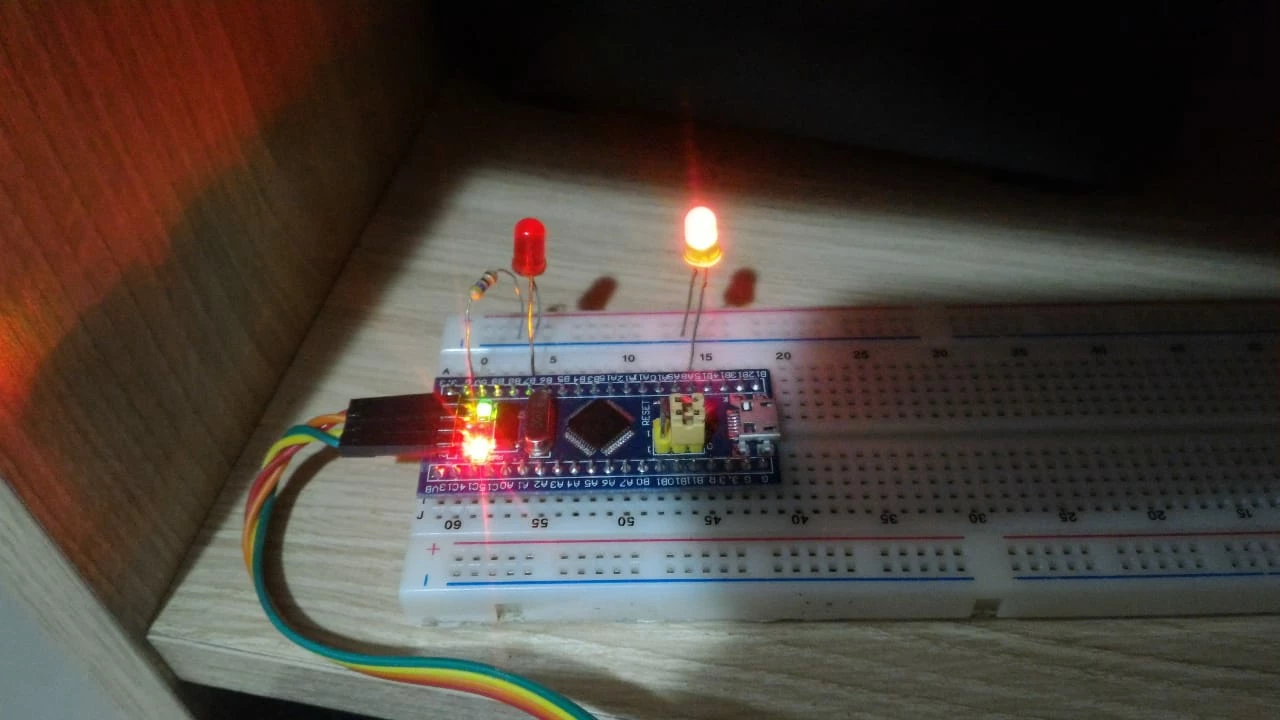

I'm a beginner in programming stm32 microcontrollers. I am developing a control for brushless motors using DMA.
I am using the microcontroller STM32F103C8T6 (Chinese development kit "bluepill") at 72Mhz.

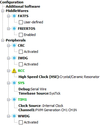

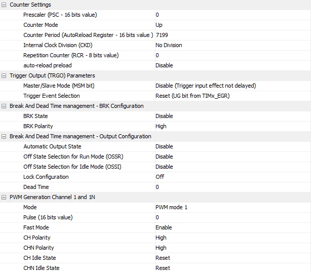

To connect two LEDs for test, set 1 TIMER1 PWM channel with complementary output (CH1 and CH1N) on the STM32 Cube MX.
At the moment I'm just testing the PWM outputs and their respective complementary outputs. But I do not know how to halt them. Only on a LED, which is connected to the PA8 (CH1) pin, does the brightness change. How do I enable companion output?
What I modified in main.c is below:

"At the moment I'm just testing the PWM outputs and their respective complementary outputs. But I do not know how to halt them. Only on a LED, which is connected to the PA8 (CH1) pin, does the brightness change. How do I enable companion output?"
Use TIMER API to halt PWM on desired channels;
HAL_TIM_PWM_Stop(&htim1, TIM_CHANNEL_1);
HAL_TIMEx_PWMN_Stop(&htim1, TIM_CHANNEL_1);
