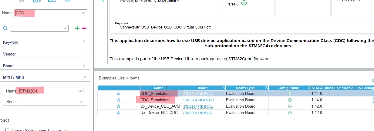

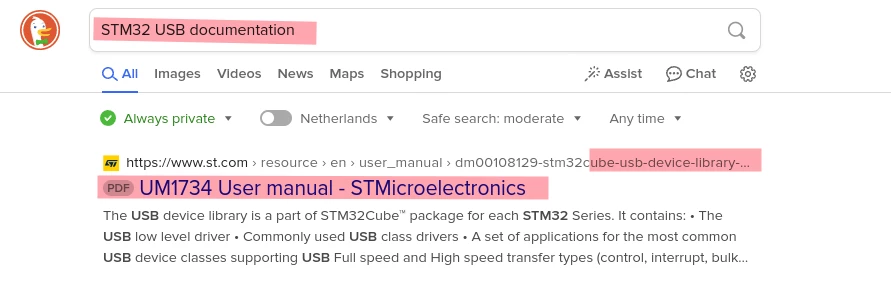

What diagnostics can be run on PC and STM32 to debug failing USB virtual COM port?
I have an STM32G4 board that is to function as a virtual COM port via USB.  This is my first attempt at implementing USB. Within CubeIDE, I enabled the USB feature and configured a middleware device for the virtual COM port. I’m not seeing the PC react in any way when I connect the board. I’m not sure where to begin to debug and I don't see any examples for the STM32G, so I'm also not sure if I've completed all the needed steps for it show up as a PC device.

@KHarb.1 wrote:
 Debug: I don't have a good example for the G4,
And did you look for examples?
> let alone documentation for the USB code.
And did you look for documentation?
As far as getting the device to simply enumerate, there's no real need for an example. You just configure the USB peripheral as a CDC device in Cube and generate the code. On the software side of things, nothing more is required for the board to show up as a COM Port in windows device manager.

Debug: I don't have a good example for the G4, let alone documentation for the USB code. I suspect I'd hit timeouts while debugging as well, which would make the process a nightmare.
