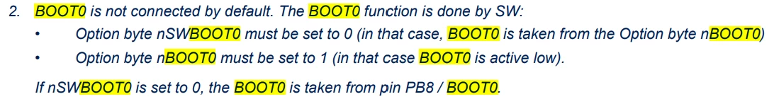

mƎALLEm
January 26, 2024
Check your BOOT pin. It's floating.
Check the application note AN5093 Getting started with STM32G4 series hardware development boards / Figure 8

January 26, 2024
> But if I disconnect the programmer and reboot - it hangs at the first call to HAL_Delay.
How are you determining this exactly without a debugger attached?
Feels like a floating BOOT0 pin would explain the general behavior.

Tesla DeLorean
Guru
January 26, 2024
In most STM32 BOOT0 is it's own pin, here it shares functionality with PB8
Check that their aren't Option Byte settings to perform an equivalent function, ie boot into user flash by default.
Make sure that SystemInit() sets SCB->VTOR to your Vector Table address
