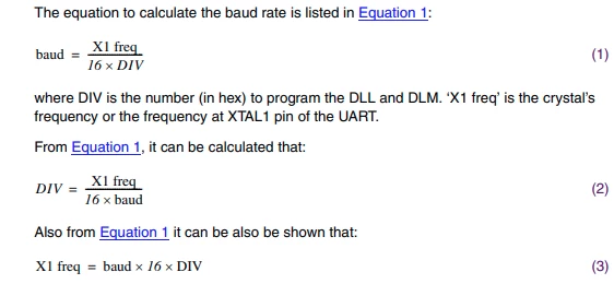

What constitutes the 16 in the baud rate equation?
Hi ,all.
I wanted to understand where the 16 in this equation comes from, cna anyone epxlain?0693W000004JKngQAG.png

Inside one one bit window the signal is sampled 16 times.
