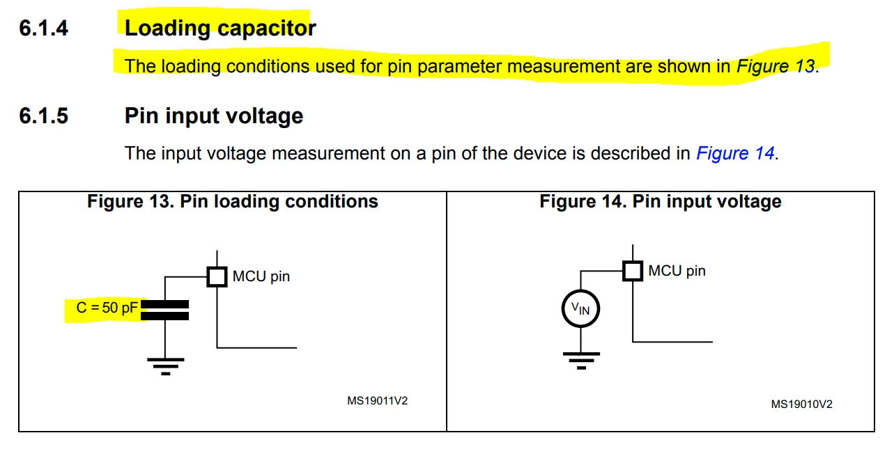

what capacity is this
I couldn't find it in the datasheet,, what capacity is this0693W00000GZTUOQA5.png

    November 30, 2021
    It's described in the datasheet:

    November 30, 2021
    It is the load capacitance, resulting form the connected inputs and connecting copper traces
    TDKBest answer
    November 30, 2021
