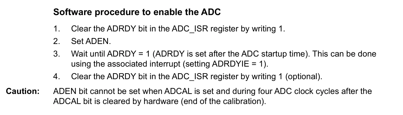

TDKBest answer
Jan 20, 2026 3:16 PM UTC
Wait until calibration is done before configuring the ADC.
You're not really following the RM procedure for how to enable the ADC.

Thanks! I had a hunch that I had overlooked something relatively simple.
This made a huge difference:
 ADCHandle->Instance->ISR = ADC_ISR_ADRDY; // Clear ADRDY flag
 ADCHandle->Instance->CR |= ADC_CR_ADEN; // ADC enable
 while (!(ADCHandle->Instance->ISR & ADC_ISR_ADRDY)); // Wait for ADC ready
Much appreciated! :)
