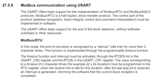

I am implementing a Modbus Master on a STM32F722.
First, transmissions and receptions were managed through Rx/Tx interrupts. But as I got a lot of overrrun errors while getting my slave's responses, I decided to transfer received packet through DMA to my Rx buffer to avoid microcontroller's overuse. As my board is a modbus master, I use RTOR to generate an interrupt when slave finished its transfer, as adviced in STM32F7's reference manual. Here is my initialisation function:

Note: do not take care about DMA configuration for Tx. In practice it is not used
As I am in half duplex, I enable Rx reception as soon as transmission is complete :
 case MODBUS_STATE_CORE_MASTER_FRAME_SEND:
 if(DataRS485->Config.EmissionTrameEnCours == 0)
 DataRS485->ModbusCoreState = MODBUS_STATE_CORE_MASTER_FRAME_WAIT_REPLY;
 // lancement de l'ecoute pour la reception
 startRxDma();
 break;
with
void startRxDma(void)
 // set timeout on idle
 MODIFY_REG(huart2.Instance->RTOR, USART_RTOR_RTO, MODBUS_TIMEOUT_IN_BITS);
 // enable timeout IT
 SET_BIT(huart2.Instance->CR2, USART_CR2_RTOEN);
 HAL_UART_Receive_DMA(&huart2, RS485Master.RX, UART_RX_BUF_SIZE);

Modbus is a master/slave protocol, where slaves can "speak" only when master is sending them a question, so I am expecting only a packet from my slave (no continuous streaming). Moreover, reception and transmission cannot be done simultaneously, as my hardware is half duplex, ie transmission and reception are done on the same line. So I enable reception only after the end of transmission of a packet.
Which callback are you talking about? There are so many...
Received packets are supposed to be transfered to Rx buffer (RS485Master.RX) thanks to DMA as soon as they arrive in UART's reception register, and I do not need circular buffer mode, as I am only expecting one frame per reception, as stated in my DMA's initialisation function (please look at my first post).
UART will fire a receiver timeout interrupt when an idle state of 24 bits length (value of MODBUS_TIMEOUT_IN_BITS) is detected on the line after the reception of the last character. My HAL_UART_IRQHandler will handle it:

As explained in STM32F7's reference manual, DMA transfer may continue after a software disabling of the stream. The software shall wait that DMA's transfer complete interrupt fires before reading data, to ensure that all of them have been successfully transfered (sorry, I did not tell that in my first post). Here is my DMA transfer complete handler:

 if(&hdma_usart2_rx == hdma)
 	// for UART Rx DMA: warn higher level that a frame has been received
			if(hdma->ErrorCode != HAL_DMA_ERROR_NONE)
				// error during reception -> ignore current frame
				ignoreNextReceivedFrame = 1;
			else if(0 == ignoreNextReceivedFrame)
				dmaTransferComplete = 1;
			else
				ignoreNextReceivedFrame = 0;
		if(hdma->XferCpltCallback != NULL)
		 /* Transfer complete callback */
		 hdma->XferCpltCallback(hdma);
 /* manage error case */
 if((hdma->ErrorCode & HAL_DMA_ERROR_TE) != RESET)
 hdma->State = HAL_DMA_STATE_ABORT;
 /* Disable the stream */
 __HAL_DMA_DISABLE(hdma);
 do
 if (++count > timeout)
 break;
 while((hdma->Instance->CR & DMA_SxCR_EN) != RESET);
 /* Process Unlocked */
 __HAL_UNLOCK(hdma);
 /* Change the DMA state */
 hdma->State = HAL_DMA_STATE_READY;
 if(hdma->XferErrorCallback != NULL)
 /* Transfer error callback */
 hdma->XferErrorCallback(hdma);
dmaTransferComplete and ignoreNextReceivedFrame are declared as volatile.
My DMA transfer complete callback:
static void UART_DMAReceiveCplt(DMA_HandleTypeDef *hdma)
 UART_HandleTypeDef *huart = (UART_HandleTypeDef *)(hdma->Parent);
 /* DMA Normal mode */
 if (hdma->Init.Mode != DMA_CIRCULAR)
 huart->RxXferCount = 0U;
 /* Disable PE and ERR (Frame error, noise error, overrun error) interrupts */
 CLEAR_BIT(huart->Instance->CR1, USART_CR1_PEIE);
 CLEAR_BIT(huart->Instance->CR3, USART_CR3_EIE);
 /* Disable the DMA transfer for the receiver request by resetting the DMAR bit
 in the UART CR3 register */
 CLEAR_BIT(huart->Instance->CR3, USART_CR3_DMAR);
 /* At end of Rx process, restore huart->RxState to Ready */
 huart->RxState = HAL_UART_STATE_READY;
#if (USE_HAL_UART_REGISTER_CALLBACKS == 1)
 /*Call registered Rx complete callback*/
 huart->RxCpltCallback(huart);
#else
 /*Call legacy weak Rx complete callback*/
 HAL_UART_RxCpltCallback(huart);
#endif /* USE_HAL_UART_REGISTER_CALLBACKS */
With
void HAL_UART_RxCpltCallback(UART_HandleTypeDef *huart)
// reception on DMA
 if((huart->Instance == USART2) && (1 == dmaTransferComplete))
 	// also disable DMA error flags
 	huart->hdmarx->Instance->CR &= ~( DMA_IT_TE | DMA_IT_DME);
 	huart->hdmarx->Instance->FCR &= ~(DMA_IT_FE);
 	frameReceived = 1;
 	// get nr of bytes got during this transfer
 	remainingBytesToTransfer = __HAL_DMA_GET_COUNTER(huart->hdmarx);
 	dmaTransferComplete = 0;
frameReceived is declared as volatile too.
My modbus state machine is watching frameReceived:
 case MODBUS_STATE_CORE_MASTER_FRAME_WAIT_REPLY:
 //On regarde si il faut décoder la trame
 // DMA reception + timeout on idle
 if(1 == frameReceived)
 	frameReceived = 0;
 	DataRS485->ModbusCoreState = MODBUS_STATE_CORE_MASTER_FRAME_DECODING_REPLY;
 //si pas de reponse
 if(DataRS485->TimerTimeout >= MODBUS_WRITE_RX_TIMEOUT)
 	if(0 == DataRS485->MaxTimeOutAllowed) // Ne pas mettre de Breakpoint ici pour éviter une Ré-Initialisation intempestive des Variables !
						HandleModbusMasterTimeOut(DataRS485);
						// stop ongoing DMA transfer !!!
						stopRxDma();
						DataRS485->ModbusCoreState = MODBUS_STATE_CORE_MASTER_FRAME_SWAP_WRITE_READ;
 	} else { DataRS485->MaxTimeOutAllowed--; } // Permet d'accepter des Délais de réponses plus long si nécessaire (certaines fonctions spéciales)
					if(DataRS485->TimerDataAvailable == 0)
						DataRS485->TimerDataAvailable = 2; //Relance la tempo pour pouvoir prendre en compte les datas recus
					DataRS485->TimerTimeout = 0;
 break;
...  then in state MODBUS_STATE_CORE_MASTER_FRAME_DECODING_REPLY, a frame check will be done (last 2 bytes of a modbus frame are a CRC16 checksum):
 case MODBUS_STATE_CORE_MASTER_FRAME_DECODING_REPLY:
 //Statistiques
 if(DataRS485->NbTrameRx < _U_LONG_MAX)
 DataRS485->NbTrameRx++; //Stats
 if(CheckGlobalFrameIsOk(DataRS485) == CHECK_TRAME_OK)
 DecodageModbusMaster(DataRS485);
 memset(DataRS485->RX, 0, SIZE_RX_RS485);
 else
 	HandleModbusMasterTimeOut(DataRS485); // Simule un TimeOut pour Clôturer la requête ...
 DataRS485->Config.DebutTrame = 0;
 DataRS485->IndiceRx = 0;
 break;
With
MODBUS_CHECK_TRAME CheckGlobalFrameIsOk(TYPE_MODBUS *DataRS485)
 uint16_t RX_CRC;
#ifndef RECEIVE_IT
 // dans le cas d'une reception par DMA, la taille recue est deduite du nb d'octets restants a transmettre
 DataRS485->IndiceRx = UART_RX_BUF_SIZE - remainingBytesToTransfer;
 remainingBytesToTransfer = 0;
#endif
 if(DataRS485->IndiceRx > 3)
 //Calcul du CRC
 RX_CRC = CRC16((unsigned char *)DataRS485->RX, (DataRS485->IndiceRx) - 2,0xFFFF);
 //Si le CRC est correct
 if ( ((unsigned char) (RX_CRC) == DataRS485->RX[(DataRS485->IndiceRx) - 2]) && ((unsigned char) (RX_CRC >> 8) == DataRS485->RX[(DataRS485->IndiceRx) - 1]))
 //Statistique
 if(DataRS485->NbTrameRxCrcOk < _U_LONG_MAX)
 (DataRS485->NbTrameRxCrcOk)++;
 if ( (DataRS485->RX[0] == pCurModBus->Address) || (DataRS485->RX[0] == MODBUS_ADR_BROADCAST) )
 //Statistique
 if(DataRS485->NbTrameRxCrcOkAdrOk < _U_LONG_MAX)
 (DataRS485->NbTrameRxCrcOkAdrOk)++;
 if(DataRS485->CurrentCptReceptionOKPerSecond < _U_INT_MAX)
 DataRS485->CurrentCptReceptionOKPerSecond++;
 return CHECK_TRAME_OK;
 return CHECK_TRAME_BAD_ADRESS;
 return CHECK_TRAME_BAD_CRC;
 return CHECK_TRAME_TOO_SHORT;
remainingBytesToTransfer is volatile too.
But at reception of 3rd frame, the value stored in remainingBytesToTransfer is not the same as the one in DMA's NDTR register, although the frame in Rx buffer is correct... :thinking_face: I wonder how this can happen...
Karl Yamashita
Karl YamashitaBest answer
Principal
May 29, 2024
You're doing more work than needed. Use HAL_UARTEx_ReceiveToIdle_DMA and  HAL_UARTEx_RxEventCallback instead.
See this project for better understanding how to use HAL_UARTEx_ReceiveToIdle_DMA to your advantage
https://github.com/karlyamashita/Nucleo-G431RB_Three_UART/wiki
In your case you don't need a ring buffer as the receive buffer won't get overwritten until you transmit another message to the slave.
If a reply has proven helpful, click on Accept as Solution so that it'll show at top of the post.CAN Jammer an open source CAN bus hacking toolCANableV3 Open Source
ABous.3
ABous.3Author
May 31, 2024
Hi Karl,
I updated my HAL & CMSIS drivers to be able to use the functions you adviced, and now it works perfectly! Thak you for your help.
Regards,
Agnes
