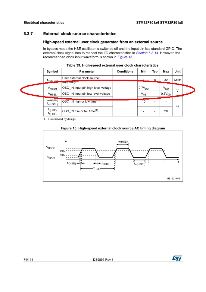

What are the voltage levels for RCC_OSC_IN
I want to use a HSE BYPASS Clock Source configuration with an stm32f301k6t.
Unfortunately I could not find any information in which voltage range my external oscillator should operate.
Sorry if the answer is trivial, I'm no expert in electrical engineering.

sorry for this rtfm question
