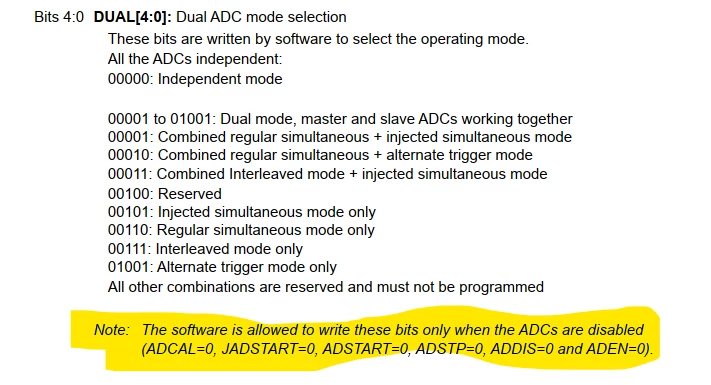

 I found that one mistake is done. I have enabled both the ADCs and then dual-mode selection done but it violates the process recommended by ST as below screenshot. What could be the consequence of it?
July 20, 2021
The consequence of doing something not allowed per the RM is unspecified behavior. Maybe it’ll work, maybe not. Maybe it’ll work only sometimes.
