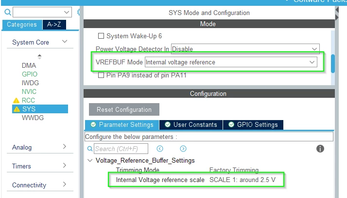

But, is it still possible to use the internal voltage reference buffer which has the option of selecting 2.5 V or 2.048 V like stated in "RM0444 - 17.2 VREFBUF functional description"?
The reason that I'm asking is that I can't find the setting for this in CubeMX for package STM32G071GBUxN.
For package STM32G071RBTx, which are the device used on the Nucleo-G071RB board, this setting can be found on the in CubeMX where in SystemCore->SYS you can select "VREFBUF Mode" and select "Internal voltage reference":
0693W00000UFPHCQA5.pngWhere after, it is possible to select the desired "Internal Voltage reference scale".
Therefore: Is the internal voltage reference available on devices without VREF+ pin?
If yes: Is this setting available somewhere in CubeMX?
Best Regards
Miguel

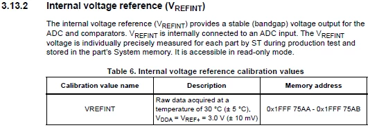

Oct 6, 2022 1:58 PM UTC
Hi @ONadr.1​
Thanks for your input. I'm trying to get my head around this :smiling_face_with_smiling_eyes:
According to the STM32G071x datasheet p.25:
0693W00000UnVi2QAF.pngThen I assume that I should be able to correct the my measurements using this value.
The value saved in my device on my Nucleo-G071RB fetched from memory address 0x1FFF75AA are:
0x67B (1659)

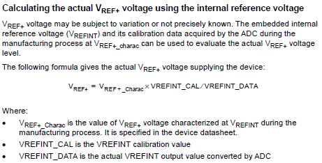

Then; from RM0444 p.378 we have:
0693W00000UnVjoQAF.pngWhen I get the ADC value from VREFINT (ADC_ch13) I get: 0x62F (1583).
Then, using the formula above:
VREF+ = VREF+_Charac × VREFINT_CAL �?� VREFINT_DATA = 3.0V x 1659 / 1583 = 3.144V
But when I measure the Supply/Reference voltage of the Nucleo board it is 3.306V
That is a deviation of (3.306-3.144)*100/3.306 = 4.9%.
I were hoping for more precision.
Am I misunderstanding something here?
BR Miguel

Did you perform ADC calibration as outlined by Calibration (ADCAL) subchapter of ADC chapter in RM, before taking the measurement?
FwMaker
FwMakerAuthor
Oct 7, 2022 12:20 PM UTC
Thanks @Community member​ :thumbs_up:
That was just what I needed. With the offset calibration and use of the factory stored calibration data, then the deviation is only 0.054%!!!
