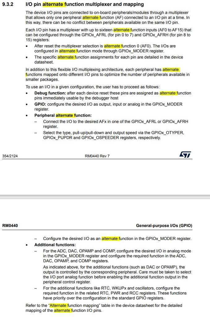

Its the pin function setting.
i.e. if you want PA1 (in your example) to use UART then you have to select Alternate Function 7. A different pin function e.g. I2C will be a different Alternate Function.
The value you select is loaded into the GPIOx_AFRL / GPIOx_AFRH registers.
See page 272 of RM090 for an explanation of Alternate Function GPIO Multiplexing:
https://www.st.com/resource/en/reference_manual/dm00031020-stm32f405-415-stm32f407-417-stm32f427-437-and-stm32f429-439-advanced-arm-based-32-bit-mcus-stmicroelectronics.pdf

AFx represent as said @###### the alternate function number x. you can configure a pin for a specific AFy by writing y to specific 4 bits of the:
  • GPIOx_AFRLx if the pin is pin n (n = 7 to 0)
  • GPIOx_AFRHx if the pin is pin n (n = 8 to 15).
For more details, take a look at the RM0440. pages 365/366
Best Regards.

I have searched in the wrong Datasheet. There i could not find the meaning of the AF numbers. I really dont like having two datasheets!
Tesla DeLorean
Guru
November 28, 2023
The Data Sheet/Manual covers the pin level stuff as there are multiple packages with different pins and sizing.
The Reference Manual covers a lot of the general die / family level stuff, the registers and peripherals, some of which won't escape from smaller packages.
They've been doing this for more than a decade, don't anticipate this strategy changing.
