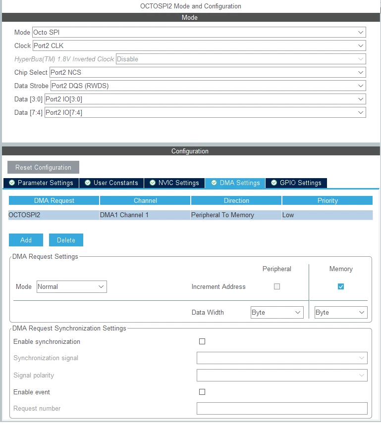

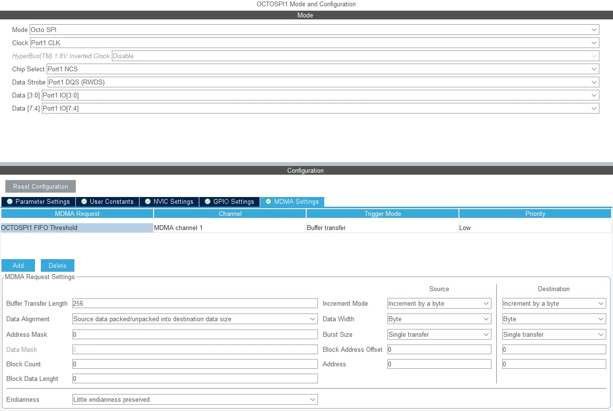

Those are the setting for STM32H7A3IIT6Q ?  (there is AN5050 where they show but DMA setting only)
I am trying to use
HAL_OSPI_Transmit_DMA(&hospi2, aTxBuffer)
(I have this chip working in interrupt mode fine , HAL_OSPI_Transmit_IT(&hospi2, aTxBuffer) but not MDMA)
I have this working for STM32L4P5G with following settings

Hello @MNapi ,
Could you please give more details about the issue?
Please try to increase the "Priority" of the "OCTOSPI1 FIFO threshold" and disable interrupts before calling HAL_OSPI_Transmit_DMA.
Please check those links to understand more about the MDMA and its channels : LINK1  , LINK2 and STM32Cube Expansion Package for STM32H7 Series MDMA.
May this discussion can help you.

The settings for MDMA in this chip are a little different. This is what I am trying to find out, how do I setup the MDMA.
I do have the OCTO SPI working STM32H7A3IIT6Q.
There a lot of examples for DMA and QSPI.
There is example for DMA and OSPI
But I cannot find how to setup for MDMA and STM32H7A3IIT6Q.
