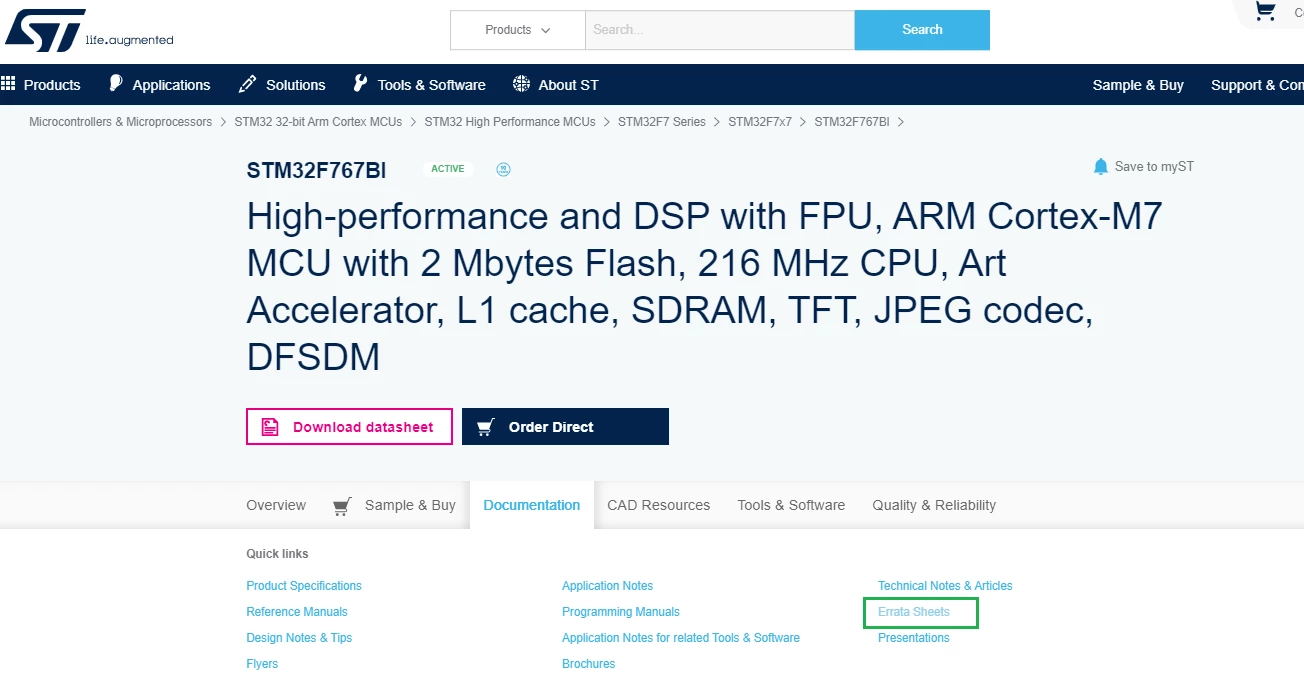

Is their ant errata sheet for STM32F767BIT6 VS STM32F777BIT6.
Oct 9, 2020 8:18 AM UTC
Hi @NJENN.1​ ,
Here is the Errata sheet applies to the part numbers of STM32F76xxx and STM32F77xxx devices: ES0334 STM32F76xxx and STM32F77xxx device limitations 6.0
You will find all resources related to your device in the product page, in the Documentation panel:
Imen
