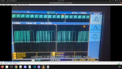

Weird Jitter when using DMA to generate PWM in GPIOs
So i was trying to generate pwm on all gpio pins of a stm32F103 for my application. I found followed this guide:https://www.hackster.io/javier-munoz-saez/all-pins-as-pwm-at-the-same-time-baremetal-stm32-1df86f
the essence is using the function:
void setSoftPWM(uint16_t pin, uint32_t duty ,uint32_t *softpwmbuffer){
	for (uint32_t i = 0; i < lengthSoftPWMbuffer; ++ i) {
		if(i<duty){//set pin
			softpwmbuffer[i]&=(uint32_t)~(pin<<16);
			softpwmbuffer[i]|=(uint32_t)pin;
		}else{//reset pin
			softpwmbuffer[i]&=(uint32_t)~(pin);
			softpwmbuffer[i]|=(uint32_t)pin<<16;
 to generate a buffer array of 100 elements which contain the gpio info for the GPIOX_BSRR register depending on the duty cycle. I configure the dma in circular mode and trigger it with a timer update event.

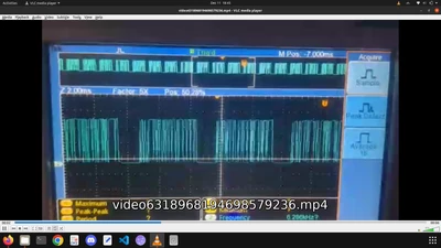

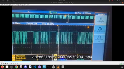

But when i upload to the MCU i am getting these waveforms on the pins:
PWM at 100% duty cycle
PWM at 0% duty cycle
PWM at 50% duty cycle:
as you can see the pwm is working somewhat but only in a very small part of the waveform. The rest of the waveform has this weird jitter.
I tried a bunch of things but am unable to eliminate the jitter. The random waveforms are completely arbitrary and change with the gpio ports and everytime i reset the MCU.
At first i thought maybe it is a hardware problem so i tried it in a different f103 and a L432kc but am getting the same result.
So its probably a software problem but no matter what i try, cant really explain or eliminate the jitter.
what am i missing here?

> sizeof(dataA)
The function wants the number of transfers, not the number of bytes.
This should be sizeof(dataA) / sizeof(*dataA), or however else you want to write it such that it's the number of uint32_t values in the buffer.

December 13, 2023
That was it! I never realized it was that simple!
Thank you so much i was stuck on this problem forever.
