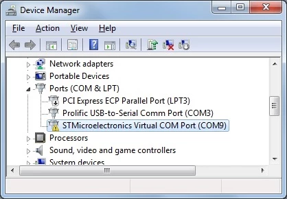

Hey Guys,
After I programed vcp for STM32F427 Eval board by following the example of STM32F429Discover board, but when I plug it into the PC, The PC can find it but always get a warning marker on the Device manager as shown below. Anyone have the idea on this problem?
    10 replies
    Tesla DeLorean
    Guru
    Jan 17, 2014 10:31 PM UTC
    Posted on January 17, 2014 at 23:31
    Like you installed the 32-bit driver on a 64-bit machine, or it expects a signed driver?
    kqian
    kqianAuthor
    Jan 20, 2014 12:22 PM UTC
    Posted on January 20, 2014 at 13:22
    I used the same driver from the STm32F4Discover board demo. It works with the discover but not on my board. I believe some thing wrong on my c code.

    kqian
    kqianAuthor
    Jan 20, 2014 4:10 PM UTC
    Posted on January 20, 2014 at 17:10
    The PC just show the driver was not successfully installed, but when I plug the Discover board in, not this error come.

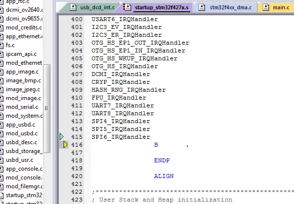

    I used the demo code from STM32F429 Discover, do some modification, and add it to my code on the STM32F427 Demo board. I found that when I plug in the USB cable, it is trapped into
    SPI6_IRQHandler
    Tesla DeLorean
    Guru
    Jan 21, 2014 11:06 PM UTC
    Posted on January 22, 2014 at 00:06
    That's actually a dumping ground for all the above mention interrupts, with weak linkage. Determine which interrupts you are enabling, and for which you have created handlers.
    Most likely one related to the USART you are using, or the code expects you to be using, or may be a TIM2 or SysTick?
