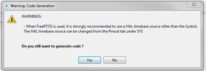

Hello Team,
While generating drivers for STM32F7 disco board with STM32CUBEMX tool I have faced the error saying THe HAL timebase source can e changed from the pinout tab under SYS.  Please below picture.  Can I still generate code or is it mandatory to change as per the warning and what would be the impact.

    Hello
    Arror.Balaraju
    You need to use other HAL time base than Systick and keep Systick as only FreeRtos Timer base to prevent dead lock issue.
    I recommend to have a look to ' 4.6Setting HAL timebase source' inside the STM32CubeMX User manual
    /external-link.jspa?url=http%3A%2F%2Fwww.st.com%2Fcontent%2Fccc%2Fresource%2Ftechnical%2Fdocument%2Fuser_manual%2F10%2Fc5%2F1a%2F43%2F3a%2F70%2F43%2F7d%2FDM001047pdf%2Ffiles%2FDM001047pdf%2Fjcr%3Acontent%2Ftranslations%2Fen.DM001047pdf
    Regards
    Imen

    Balaraju Arror
    Jul 4, 2017 3:29 PM UTC
    Posted on July 04, 2017 at 15:29
    I have gone through the document. I got answer to my question.
    Thank you,
