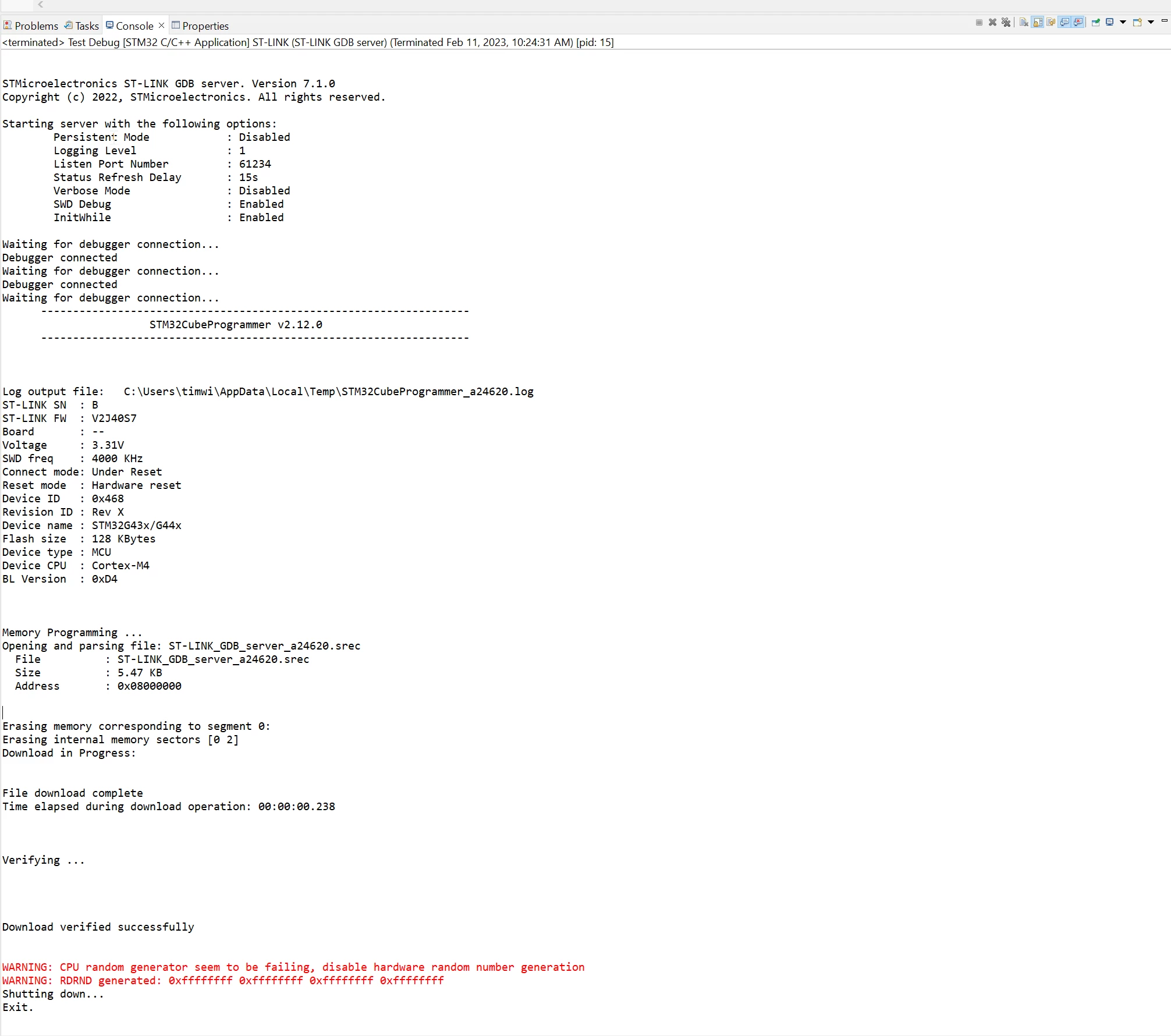

Thank you for your answer :)
you are right, it was a problem on my host PC.
i have fixed the Problem on myself with a Bios Update from my mainboard.
https://arstechnica.com/gadgets/2019/10/how-a-months-old-amd-microcode-bug-destroyed-my-weekend/
