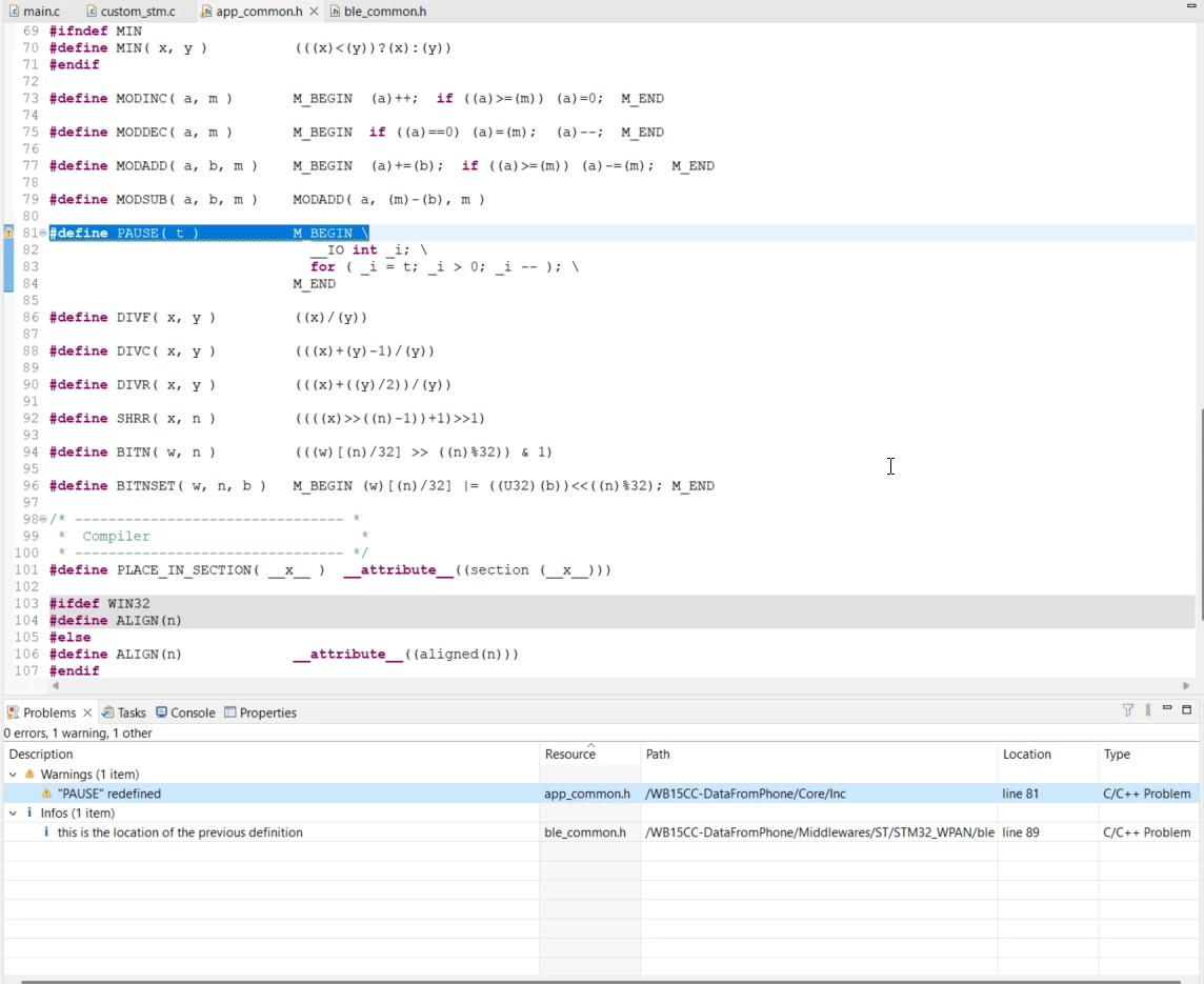

I recently create a project for a NUCLEO-WB15CC on STM32CubeMX where the output was the following:
Is there any solution for this warning?

In one of the files that defined that macro:
#ifndef PAUSE
#define PAUSE(t) ...
But need to check which PAUSE definition you need to adopt!
Seems that that warning is indicating PAUSE macro was defined differently in app_common.h and ble_common.h.
You need to check.

It's better to post the code & the messages as text - not images;
use this button:
Don't redefine it!
