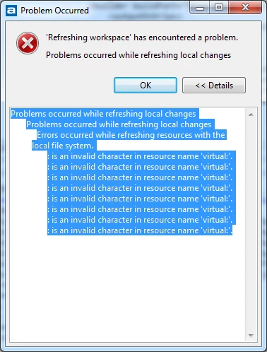

    Posted on March 25, 2016 at 17:52
    There is another issue as well. I created a project using links (root folder checkbox unchecked), and brought it up into TrueStudio.  I was able to build the project fine.  I then regenerated the code in Cube without making any changes, while the project was open in TrueStudio, and I get the following dialog box in TrueStudio after the files update due to the code regeneration.  I can close the dialog box and build the project OK, but I'm not sure why the box pops up.

    Posted on March 29, 2016 at 18:44
    Dear user,
    Thank you for reporting these issues.
    Can you please provide your .ioc file as we don't reproduce the following problem:
    BUG REPORT: When you generate code to a root folder for TrueStudio, the Driver folder that is auto-generated by the Cube will become excluded from the project every time you regenerate code. You will get a warning message related to ResetHandler, and your code size will reflect only the Cube's initialization code.  You need to manually go to Exclude from Build on the Driver folder properties and 'unexclude' the folder.
    Thank you

    Posted on April 19, 2016 at 09:43
    Dear user,
    these issues will be fixed in next release 4.15.
