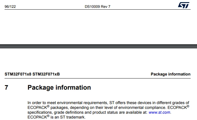

What is shelf life of STM32F071VBT6TR MCU ? How long I can store it in my warehouse before assembling it on PCB ?

In the Datasheet:
Searching the ST site for, "ECOPACK" finds, among others, AN2639:
Soldering recommendations and package information for Lead-free ECOPACK MCUs and MPUs
https://www.st.com/content/ccc/resource/technical/document/application_note/25/2e/9e/a6/a6/b4/41/f4/CD00173820.pdf/files/CD00173820.pdf/jcr:content/translations/en.CD00173820.pdf
The big thing is moisture absorption - see Chapter 6.

So here I consider that important factor is MSL level of the device, its packaging (Material Barrier Bag) and environment in which device is stored.
The MBB remains unopened and HIC has not changed its color., Please confirm.
