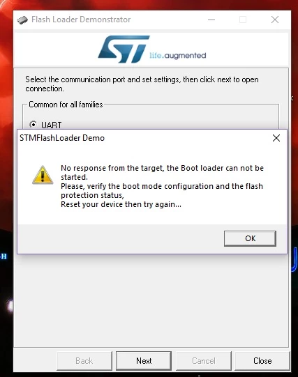

Indicating the device is not in loader mode. Make sure BOOT0 is high and reset, entry is a one shot deal. Make sure UART being used is supported by loader. Use 9600 with EVEN parity. ​

hii Clive,
Boot 0 pin is high and device on the loader mode. UART is also supported by the loader,9600,even parity,protection level also checked. i am use the correct pin out. any other reason for this error..?
entry is one shot deal..? you mean delay..?
