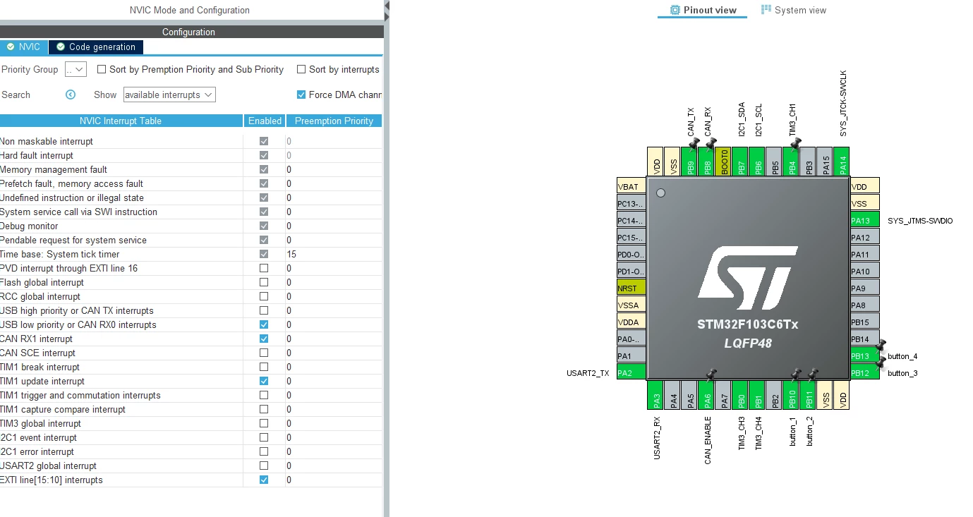

I am working on power management and I put MCU in sleep mode (no low-power), but it doesn't wake up when it receives a CAN frame, it stays in sleep mode. I would like any CAN frame to wake up the MCU.
To switch to sleep mode I use :
HAL_SuspendTick();
HAL_TIM_Base_Stop(&htim1);
HAL_PWR_EnterSLEEPMode(PWR_MAINREGULATOR_ON, PWR_SLEEPENTRY_WFI);
HAL_TIM_Base_Start(&htim1);
HAL_ResumeTick();
tick_sleep = HAL_GetTick();Can Bus configuration:

}In my code I have configure CAN Rx as interrupt.
