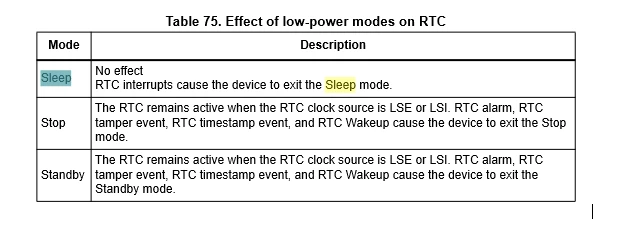

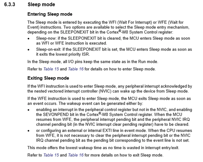

Hi everyone,
I'm working on a project and i'm a beginner on STM32F0. I have the discovery board. I have the code at the bottom of the page but i don't understand many parts of it...
In this code i have the following question :
What's the difference between this instruction
BUTTON_MODE_GPIO and this instructionBUTTON_MODE_EXTI. There is someting with the interruptions... I don't really understand. When the button mode is exti, when i press the user button, I generate an interruption ? And when the button mode is GPIO what happens ? It's a bit difficult for me ...
Normally, it works like that :
''After reset, the program waits for User button connected to the PA.00 to be pressed to enter the selected low power mode. '' In the below code, it's the SLEEP MODE.
''- When the RTC is used, the wakeup from low power mode is automatically generated by the RTC (after 5s). '' useffull for the STOP MODE ''- In Sleep mode and Standby mode, press again the User button to exit the low power mode.''
I think the BUTTON MODE EXTI is used to wake up the device from the sleep mode. But i don't know how it works... I attached two extract extracted from the datasheet of the STM It describes what is the sleep mode and how do we enter in and how can we go out from it.
