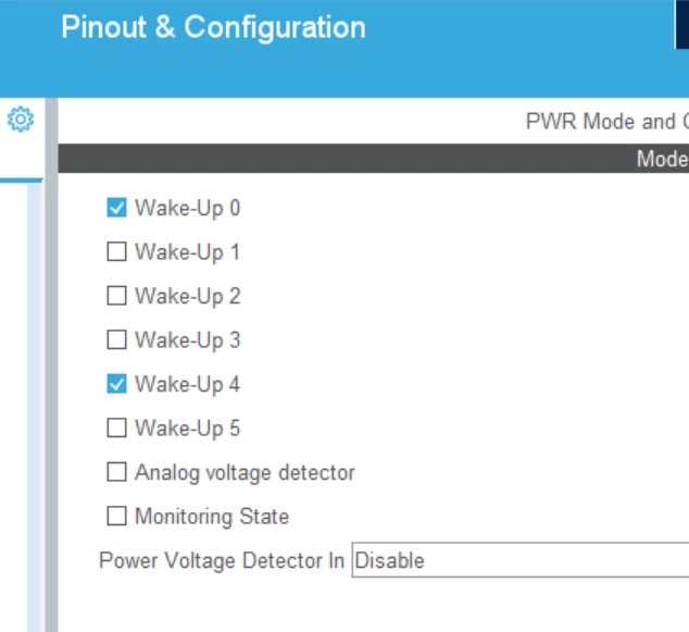

I have a custom board with an led on PD7 and Normally High push button on PI11. There is also a pushbutton set up on NRST. Device is a  STM32H743IIT6
I can get the processor to go into standby okay. This is confirmed by the __HAL_PWR_GET_FLAG(PWR_FLAG_SB) == SET being false if I repower the circuit but true if I push the NRST button. So far so good.
I can not get the processor to wake on the PI11 PWR_WAKEUP_PIN4.
HAL_PWR_DisableWakeUpPin(PWR_WAKEUP_PIN4);
 /* Clear all related wakeup flags */
 HAL_PWREx_ClearWakeupFlag(PWR_WAKEUP_PIN4);
 PWREx_WakeupPinTypeDef sPinParams;
 sPinParams.WakeUpPin = PWR_WAKEUP_PIN4;
 sPinParams.PinPolarity = PWR_PIN_POLARITY_LOW;
 sPinParams.PinPull = PWR_PIN_NO_PULL;
 HAL_PWREx_EnableWakeUpPin(&sPinParams);
 /* Enter the Standby mode */
 HAL_PWR_EnterSTANDBYMode();
I've tried rising edge too but no luck. Is there some other piece of configuration I'm missing, like enabling a clock or power domain or something?

I just tried adding code to wake on RTC timer wakeup function. This works. But wake on wakeup4 still does not.

OMG! I found it. ST HAL Library engineers please take note. This is horrible. The wakeup pins in the datasheet and in the CubeMX configuration are 0 to 5.
0693W00000GYVIDQA5.pngHowever in the HAL PWR library.... surprise! they are 1 to 6.
/* High level and No pull (default configuration) */
#define PWR_WAKEUP_PIN6 PWR_WKUPEPR_WKUPEN6
#if defined (PWR_WKUPEPR_WKUPEN5)
#define PWR_WAKEUP_PIN5 PWR_WKUPEPR_WKUPEN5
#endif /* defined (PWR_WKUPEPR_WKUPEN5) */
#define PWR_WAKEUP_PIN4 PWR_WKUPEPR_WKUPEN4
#if defined (PWR_WKUPEPR_WKUPEN3)
#define PWR_WAKEUP_PIN3 PWR_WKUPEPR_WKUPEN3
#endif /* defined (PWR_WKUPEPR_WKUPEN3) */
#define PWR_WAKEUP_PIN2 PWR_WKUPEPR_WKUPEN2
#define PWR_WAKEUP_PIN1 PWR_WKUPEPR_WKUPEN1
There is a mapping wakeup 0 is HAL wakeup 1 etc. Where is this mapping documented? Why even do this mapping? Who comes up with this stuff???? Thanks, You just cost me 1.5 days of wasted effort.
