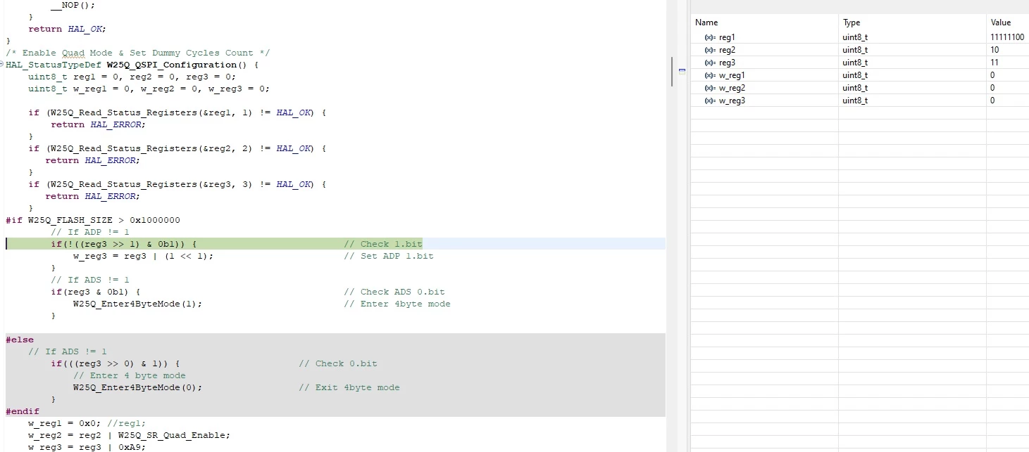

Why can i not disable the protection? I use W25Q256. I can't write and erase the flash ic.
The programming was working, but suddenly an error occurred during download. Here I noticed that the bits of SR 1 went to 1 and I can't reset them.
What could be the problem that I can't find?
I attached the picture from the readed registers.
Thank you!

Some of the older parts SR1 and SR2 must write as a pair.
The high order bit in SR1 clears via a power cycle, once set you can't change the other bits.
Yes, need to clear the BPx bits and COM
Seen a number of people jam up the parts this way.

Can you help me with what exactly I have to do to make the ic work again, what is the solution to this error? I tried quite a few things but it didn't work. Thanks
