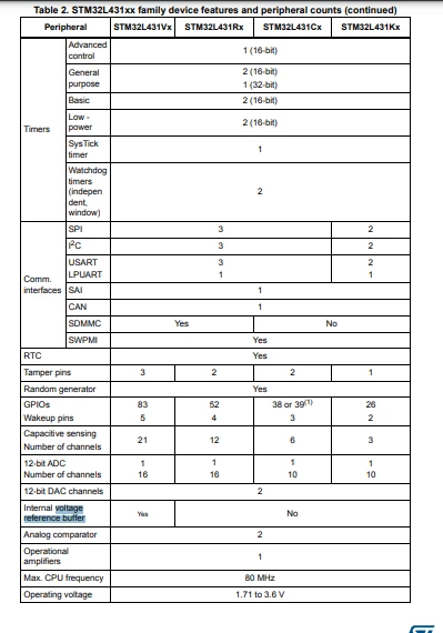

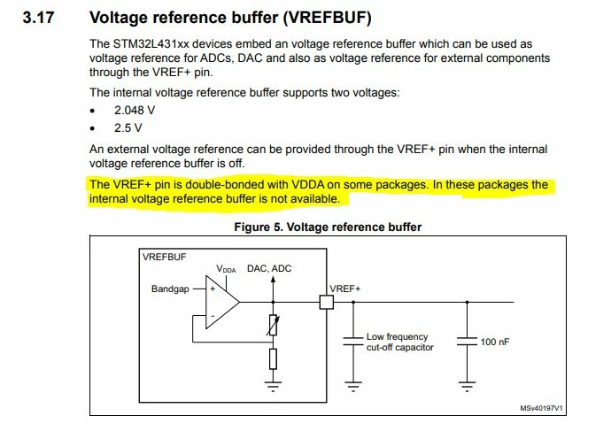

VREFBUFF is not available in STM32L431RCTx, How to enable External ADC reference?,
VREFBUFF is not available in STM32L431RCTx0693W00000QNMZNQA5.png series, in datasheet it tells that "internal voltage reference buffer is not available", is there any other option to give External ADC reference for this series of STM32. 0693W00000QNMXWQA5.jpg
No.

than what will be default ADC reference ? is it 2.5v are 3.3v in this case
waclawek.jan
September 14, 2022
ADC reference is always what's on the VREF+ pad, which in the STM32L431Rx is internally bonded to VDDA. So, in your case, the ADC reference is whatever voltage is on VDDA (in respect to VSSA).
