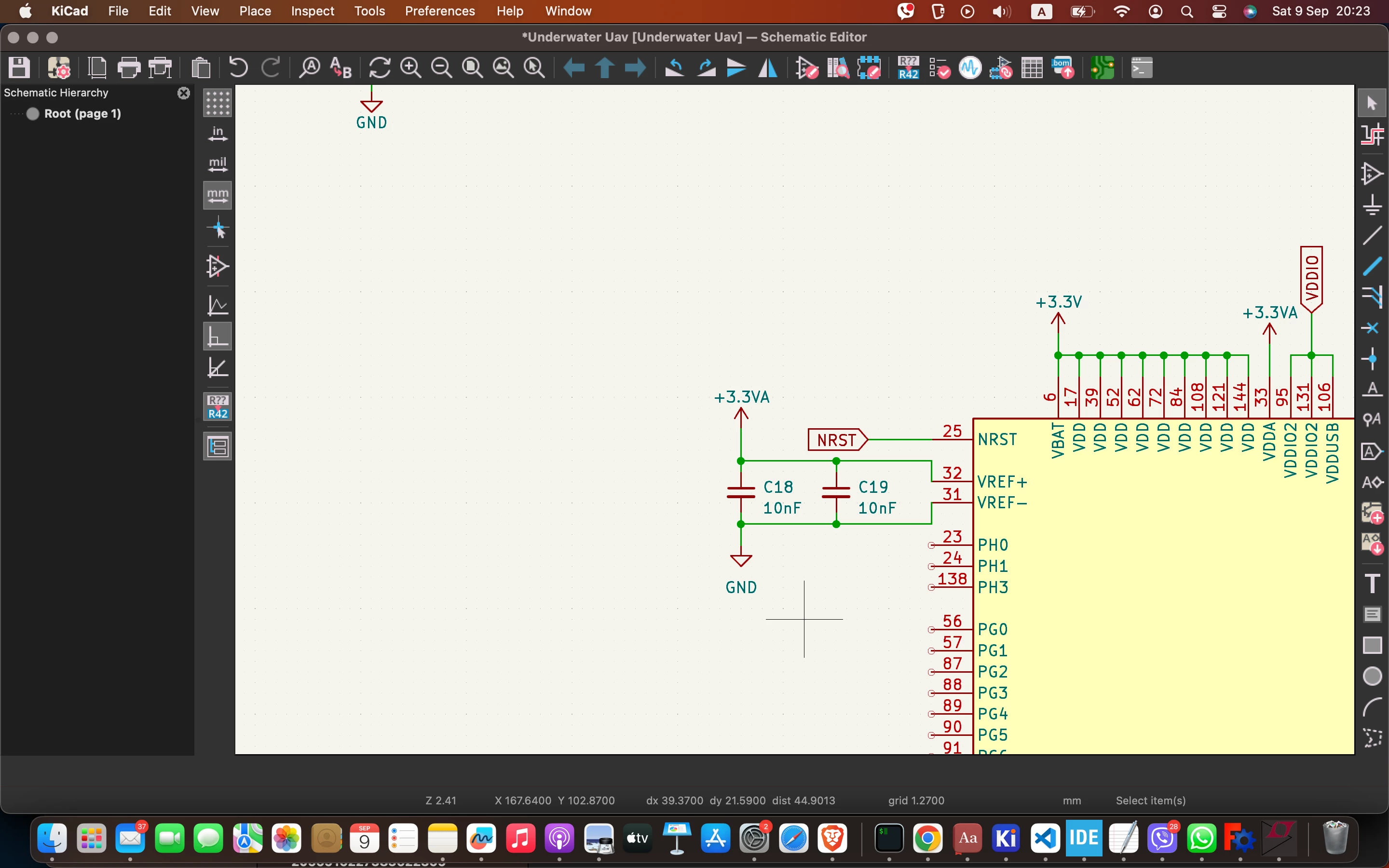

After playing around a bit and talking and googling some stuff is my vref wiring correct our should 3.3VA be removed as in some other examples

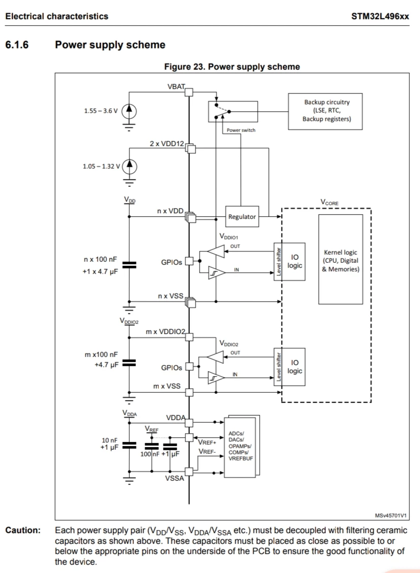

Best answer by Issamos
Hello again @Noah_Stoessel
Referring to the DS11585 Rev 17, I think you should follow this:
Best regards.
