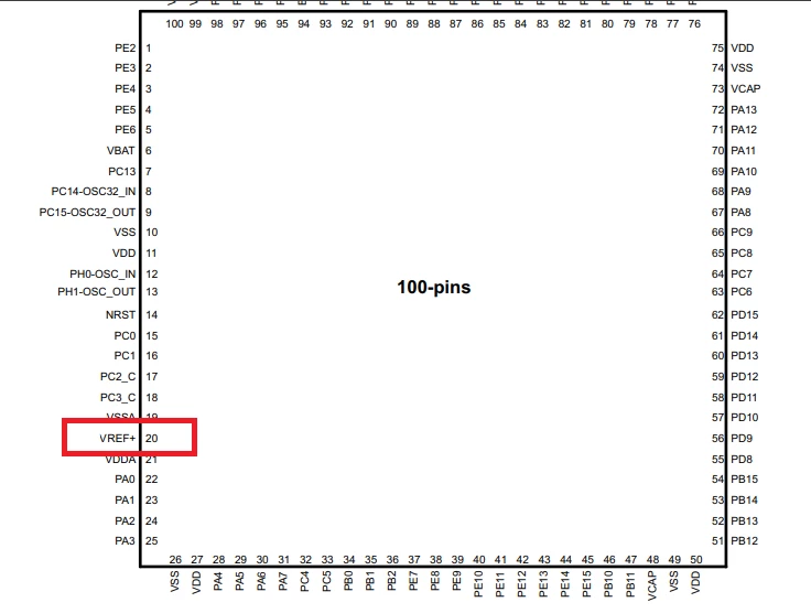

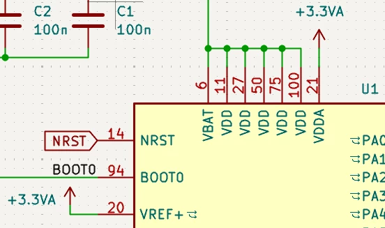

This is the first time I'm working with an STM32 and I have a question regarding the VREF+ pin. I'm creating a schematic for the MCU and I'm not entirely sure what to do with the VREF+ pin and I'd like some clarification on something. According to the datasheet, the connection between VDDA and VREF+ depends on the package type. I'll be using the 100-LQFP package and if I've read the datasheet correctly, that means that VDDA and VREF+ are internally connected? So I can just leave the VREF+ pin floating and still have access to VREF? Or would it still be best to apply a filtered voltage to the VREF+ pin externally? I have a filtered voltage supply to the VDDA pin already in the schematic and am I right in saying that if I have read the datasheet correctly, then there is no need to add another filtered voltage externally to VREF+, correct? Thanks.

Dear @felron124 ,
The shared schematics sounds good with enough filtering versus Digital VDD. VDDA and VREF+ connected to same isolated +3,3VA which is a minimum to have standard ADC accuracy and performance.  if ADC is not required VDD/VDDA/VREF+ can be the same rail as well.

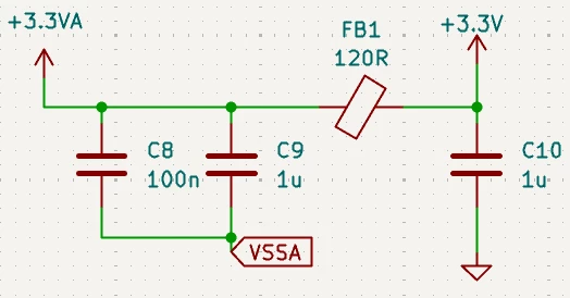

Even though it is internally connected to VDDA, it's not recommended to leave VREF+ floating. You should connect it to VDDA externally with a decoupling capacitor (typically 1µF + 100nF to VSSA) for stability.

Ok, so something like the following?
Side note: does the VDDA and VREF+ always have to be supplied with a stable 3.3v or would the 3.3v input on the VDD pins suffice for applications where the ADC isn't important? Thanks.
VREF+ and VDDA:
VDDA filter circutry:
VSSA:

Dear @felron124 ,
Ciao
According to the datasheet Vref+ is available on the LQFP100 package:

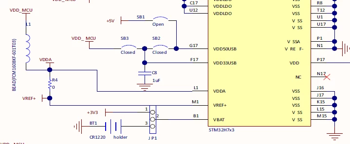

For the hardware design need to refer to the hardware getting started related to the product. In your case: the AN4938:
This is STM32H753XI reference schematic in the AN4938:
