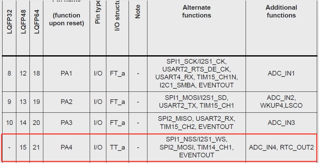

platform: STM32G070CB
phenomenon:
When the MCU is empty (without any program), connect an external pull-up resistor 10K to the adjustable voltage source on the PA4 pin, adjust the voltage in the range of 4~18V, and find that the maximum clamp of the PA4 pin is about 5V, and then test that the pin is not damaged
I suspect that this phenomenon was formed by the TVS tubes connected in parallel at the time.
My questions are:
Q1. Is there a TVS tube inside to the ground ?
Q2. What are the breakdown and recovery voltages for the TT_x and FT_x type pins?

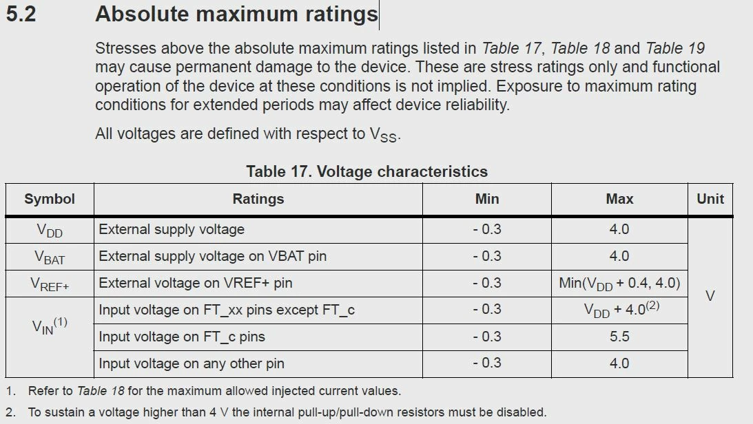

Q3. The external voltage passes through the resistor to the pin, no matter how large the external voltage is, just make sure that the pin voltage is within the maximum range (the table below) when designing, right?
For example, if 20V passes through a 33K resistor to a FT_a type pin, this pin is configured to open the drain, and the test is tested as long as the voltage on the pin is < VDD + 4.0
Thank you very much!

1) All GPIOs have protection diodes. You should generally not rely on these to protect the chip.
2) Generally, just over VDD + 4 V. Exact values are not specified.

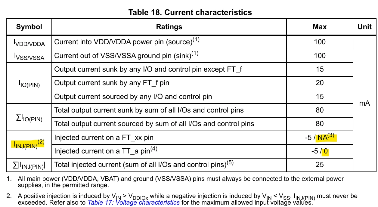

3) No, you're applying more than VDD + 4V to the pin, so that's outside of the absolute maximum value and you are now injecting current into the chip, about 0.6 mA. Look at the table for max injected current.
No positive injection current is allowed.

Regarding the above 3), External voltage passes through a 33k resistor to the pin, if VDD=3.3V, external voltage:
a). At 6V, 6<VDD+4, will there be no current injection at this time? So is external voltage safe for the system at this time?
b). At 10V, 10>VDD+4, the injected current is (10-3.3)/33=0.2mA. It's not safe. Is this understanding correct?
August 19, 2024
a. If it's an FT_xx pin other than an FT_c pin and pullup/pulldown is disaled, yes. Otherwise no. Note that PA4 is a TT_a pin and the absolute max voltage is 4 V.
b. Correct.
