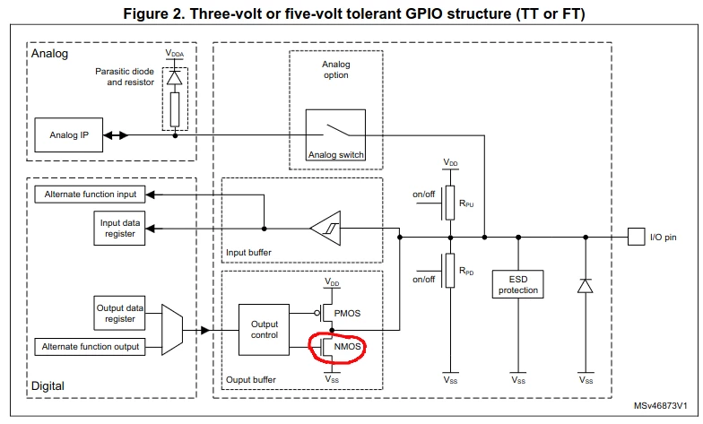

Voltage admitted on an open drain output
I need to drive some power mosfets (STP55NF06) from open drain outputs.
The gate and mcu output will be connected to a pull up resistor to 12V
Are the TT and FT pin voltage limits applicable when used in open drain mode?
If yes, I will amplify the 3V of a push pull output.
Else, it will reduce the design size.
Thanks for your reply

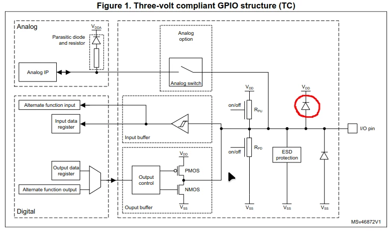

AScha.3
AScha.3Best answer
Jun 2, 2024 12:58 PM UTC
you cannot drive 12V with the open drain mode. (Only kill the cpu. :) )
Anyway - what you want to switch with a 50A mosfet at super low speed ?
In ds its driven with 4,7 ohm - so you need a gate driver, to drive it at some speed.
With open drain mode you might just switch on a battery pack or so...no pwm.

xisco
xiscoAuthor
Senior
Jun 2, 2024 1:07 PM UTC
I see in AN4899 some things:
The diode marked in red in figure 1 prevents higher voltages than VDD+0.6V on a TT pin. For this reason, my design is not possible in TT pins.
The NMOS marked in red in figure 2 has to withstand 12V (VDS) when is off without being destroyed, considering the very low current current of my pull up resistor.
Chapter 5.1.1 does not specify, but seems to refer only to inputs.
