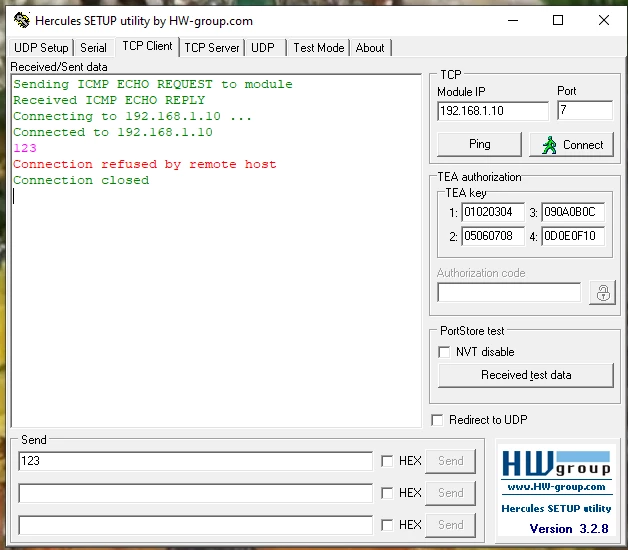

I am Using NUCLEO-F439ZI board for Ethernet Interface. I successfully transferred the data in UDP, Now I try to send the data using TCP client method.
In the .ioc configuration file, I followed the below setup
1. Connectivity -> ETH -> RMII mode.
2. Middleware and Software Packs -> LWIP -> General Setting -> LWIP_DHCP (set own IP -> 192.168.1.10)
 Middleware and Software Packs -> LWIP -> Key Option -> heap memory size = 10*1024 bytes.
 Middleware and Software Packs -> LWIP -> HTTPD -> LWIP_HTTPD - enable
after all this setup I generate the code
In the Main.c file
1. by using this code I ping the connection, its works fine "extern struct netif gnetif;
ethernetif_input(&gnetif);
sys_check_timeouts();".
2. from this sub function "tcp_server_init();",
To create a TCP block,
Bind the socket to Server Address
Listen from client
Accept function - connection between client and server
After done all this process it successfully debugs and make the connection successfully

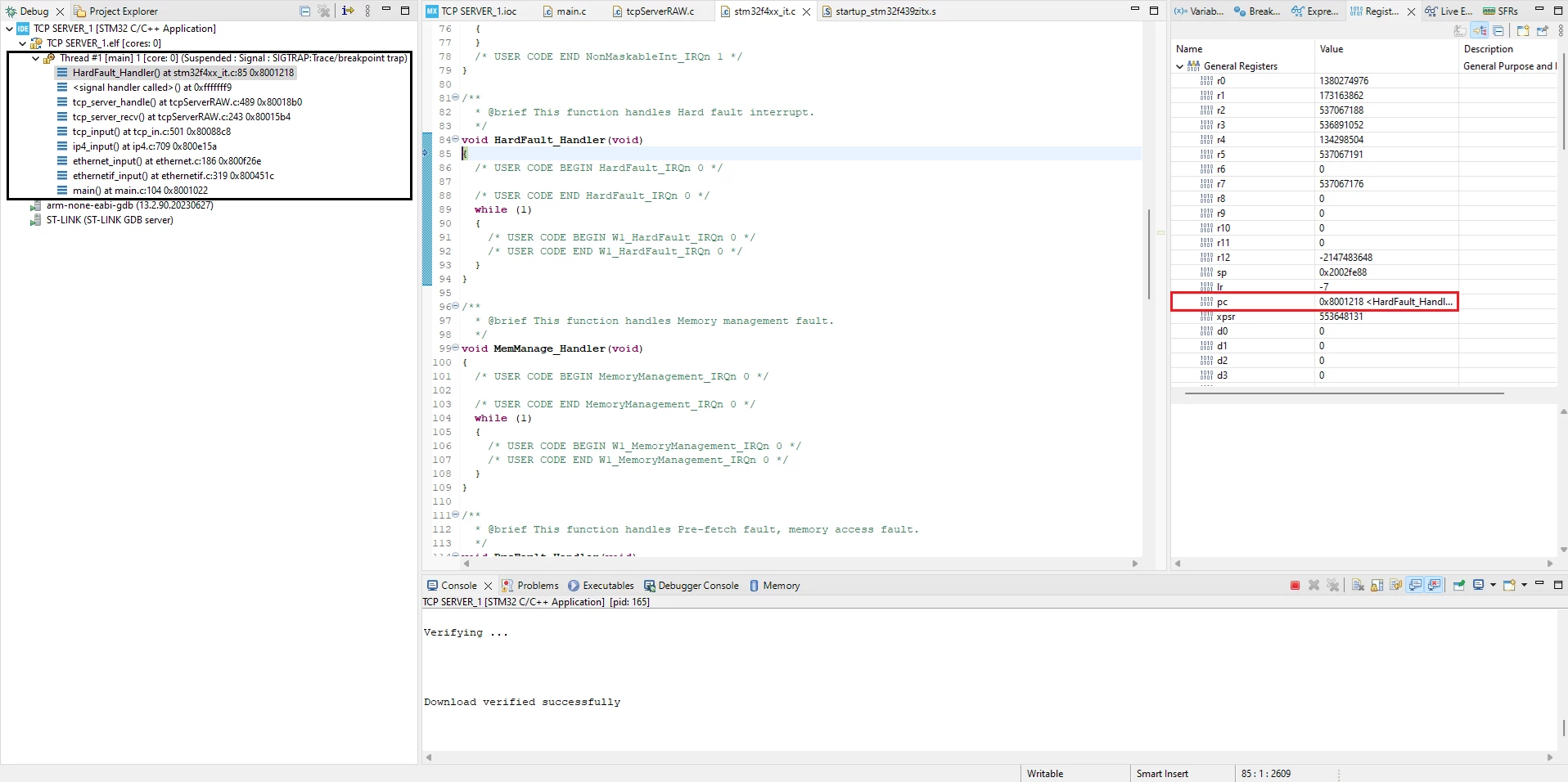

The connection made successfully, whenever I try to send the data, the following error
occurred. The below attachment shows the error.
In the "static void tcp_server_handle (struct tcp_pcb *tpcb, struct tcp_server_struct *es)" function I changed the code this code " char buf[100]; memset (buf, '\0', 100); strncpy(buf, (char *)es->p->payload, es->p->tot_len);
strcat (buf, "+ Hello from TCP SERVER\n"); " to " int len = sprintf(buf, ""%s + Hello from TCPServer\n",(char *)es->p->payload);" the above error was cleared. but my data was not transfer to client, I don't know where I do the mistake. notify my error and mistake.

Hello @Ramachandran1992 ,
After an examination of the attached file, it seems  tcp_server_handle you are implementing is unable to properly allocate a buffer this should be done with the Pbuf_alloc function.
my recommendation is to take the example we give in the cube Firmware which can be obtained from Github or from the ST website as a reference so the revised version of your tcp_server_raw.c will be as follows :
 * @file LwIP/LwIP_TCP_Echo_Client/Src/tcp_echoclient.c
