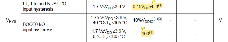

What is the correct Vhys parameters for STM32F2xxx MCU I/O ports?
It looks like as wrong datasheet values here (DS6329 Rev 18):
https://www.st.com/resource/en/datasheet/stm32f207vg.pdf#page=102
0693W00000Suc2xQAB.pngThe published values are too big.
Please double check the chapter Table 46. I/O static characteristics for valid parameters and give me feedback asap.
Thank you in advance.

The 100V for sure
The 45%VDD + 0.3V perhaps less so
