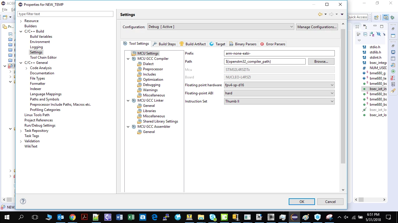

VFP register arguments on STM32L4R5ZI System workbench
Posted on May 31, 2018 at 12:29
When I compile the STM32L4R5ZI BME680 libary, I got the error message of use VFP register arguments,
Can anyone let me know how to fix  inside the AC6 SW workbench?
Thanks
Phani

    Try different combinations of the float configuration flags
    -msoft-float
    -mfloat-abi={soft,softfp}

    You'd need to determine the settings for the FPU used in the library
    -mfpu=fpv4-sp-d16 -mfloat-abi=hard
    If hard doesn't match, try the soft ABI setting, or NOT using the FPU

    It's complaining it is mis-matched, work through the FPU setting options if you can't tell from inspecting the library

    -mfloat-abi=soft -mfpu=fpv4-sp-d16 -L worked and got build but
    Now its failing in SystemClock_Config.
    And entering to WWDG_IRQHandler() at startup_stm32l4r5xx.s:132 0x8009dc0
    Failing at
    if(HAL_RCC_ClockConfig(&RCC_ClkInitStruct, FLASH_LATENCY_4) != HAL_OK)
    /* Initialization Error */
    _Error_Handler(__FILE__, __LINE__);
    Thanks
