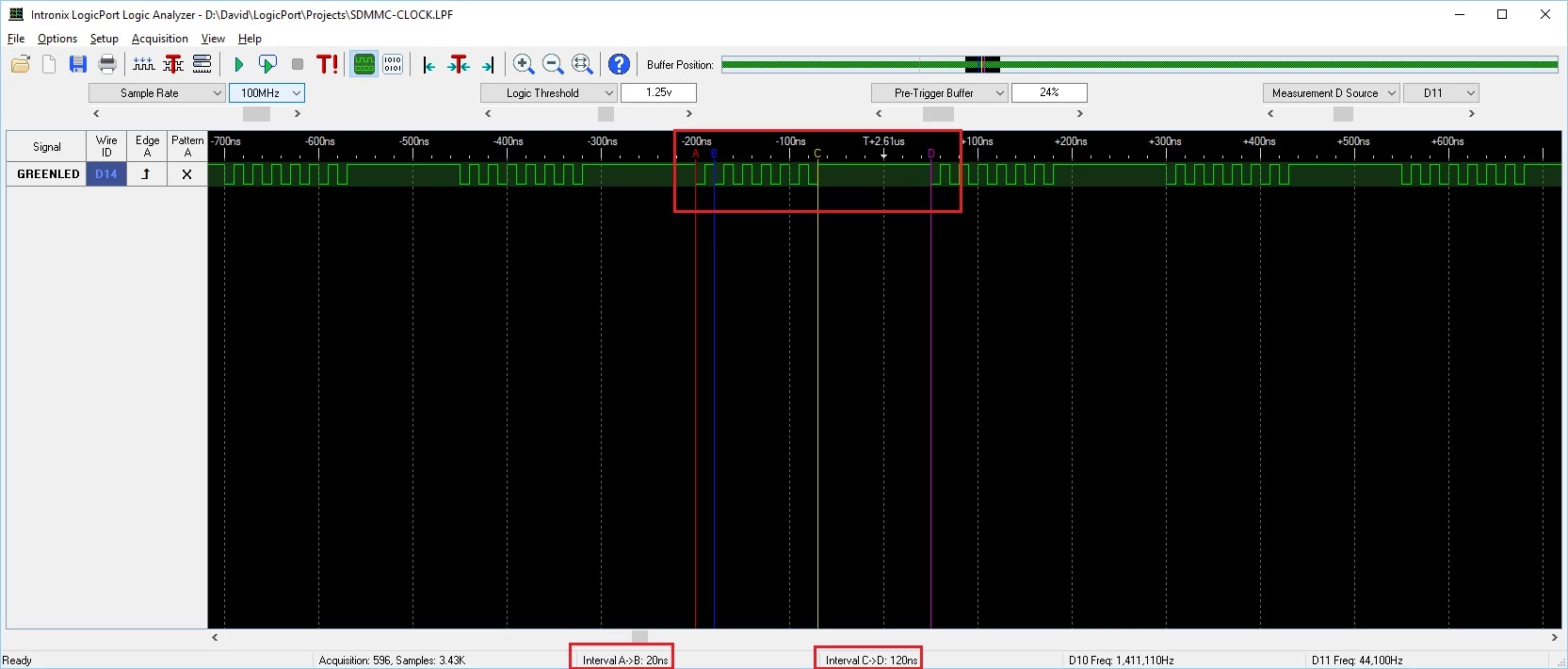

Hi all. I am using the
STM32F746NGH6
 on the STM32F7 Discovery board to read from a micro-SD card through FATFS.
I am able to get only around 1MByte/sec read performance when reading blocks of 512 bytes. My application requires at least twice this read speed.
I am accessing a file through Chan's FATFS and the block size is fixed at 512 bytes. My SDMMC driver code is basically bare metal, so all the STD PERIPH and HAL crap has gone. It is pared down to the bone, as it were. I am using the 4 bit mode and the high speed clock mode and DMA mode reads. The clock speed, as verified by my logic analyzer, is indeed around 50MHz.
Given the above configuration, I should get blazing read performance, but the elapsed time to perform the 512 Byte read is sluggish, around 430 - 660 us. This is verified both by a hardware timer and an LED turning on, then off, after the block read and measuring that LED on time with my logic analyzer.
I am using a Class 4 micro-SD card.
I have attached a JPG showing a screen shot of the SD card clock. That image verifies the clock speed as about 50MHz, but interestingly it also shows that the clock comes in bursts of 7 clocks followed by a gap of 120ns. Thus the clock is not clocking in data continuously and therefore is losing about 1/2 of the available time to read the data in.
I have also attached a ZIP file with my SDMMC driver code.
Can anyone shed any light on why my SD MMC clock is so bursty and not continuous, or shed any other light on my poor read performance.
Thanks for any help you may be able to give.

    Don't read/write single blocks, the command overhead will eat you. I benchmark with 32KB of blocks. Find a sweet-spot that balances the speed you want and the memory you have to spare, try 4KB, 8KB, 16KB and 32KB

    Posted on January 30, 2017 at 22:21
    Yes, indeed. When I Increase the buffer size to just 4KBytes, I get a raw SDReadBlocks access of 10MBytes/sec and through FATFS f_read of about 6MBytes/sec. However I can't directly using this size buffer without redesigning other parts of the system since that large buffer size currently causes large latencies elsewhere.
    Thanks for reminding me of the huge SD card overheads in reading data.

    Posted on January 30, 2017 at 19:43
    Actually my code originated from the STM32F7 HAL SDMMC driver. I simply stripped out all the unecessary HAL clutter and reduced it to direct register access. But the algorithm and SD card read access process is exactly the same.
    After looking at the problem some more, I have discovered that the issue is not bus bandwidth or memory bandwidth. I see very little change in overall read access time for a 512 byte block whether I use a1 bit bus, 4 bit bus, DMA or polled or standard speed or high speed Therefore I can only come to the conclusion that the bottleneck is not the code or the bus bandwidth but the SD card itself.
    Here is where Clive's comment comes in - yes, I do remember that there is an overhead for any SD card access but I am surprised at how much that is. I am about to do more measurements to try and quantify it.
    I have reasons for wanting a small buffer size and accessing 512 bytes at a time since a large buffer size creates latency elsewhere in the system. But I may to rethink my whole SD card access and sample processing strategy to allow larger SD card accesses but retain smaller DMA buffer dumps to my DAC.
    I will post some result later after some measurements.
