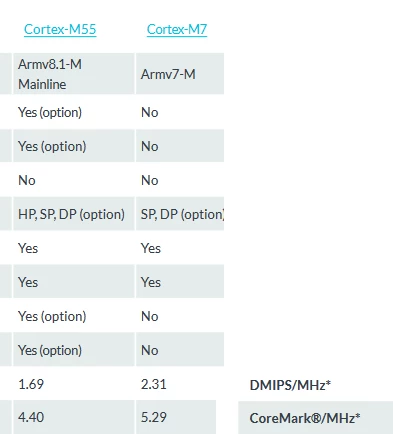

Why does Sharable RAM perform so poorly?
In my NOP test, the H7 is still about 30% faster than the N6, despite the N6 running at a higher clock speed. My assumption is that the H7’s memory scheme (code executed in FLASH with the ART accelerator) is more efficient than the N6’s cache-based approach.
Anyway, I’d like to thank you all for your great support.

What exactly is being reported on the "Min / Max" line? The two readings aren't consistent with each other as far as I can see. If it's time per test, the smaller array should be faster. If its total time for all tests, the math doesn't add up. 1000*1000 values take 1110 us but 100*50000 values only take 107 us? Nah.
Showing actual code being used here might help and avoid the 20-questions back and forth and get an answer faster.

Note also that the M7 core is faster than the M55 on a per-MHz level.
Might also be running into bus contention issues with code and data being transferring over the same bus. Some sources on the internet say a 2-3x speed difference, which is what you're seeing.
> So, the H7 @ 480 MHz is effectively 3.35× faster than the N6 @ 588 MHz.
I calculate a 2.53x difference, not 3.35x.

You are right: the M7 is faster than the M55 per MHz.
In my test, the N6 shows a speed advantage of a factor 1.22, which should place it roughly at the same level as the H7. So, the 588-MHz N6 CoreMark is 4.40 x 588 = 2'587.2 and the 480-MHz H7 CoreMark is 5.29 x 480 = 2'539. So, both machines should give very similar results on my tests.
In some tests, I even see an execution time ratio of >4.
