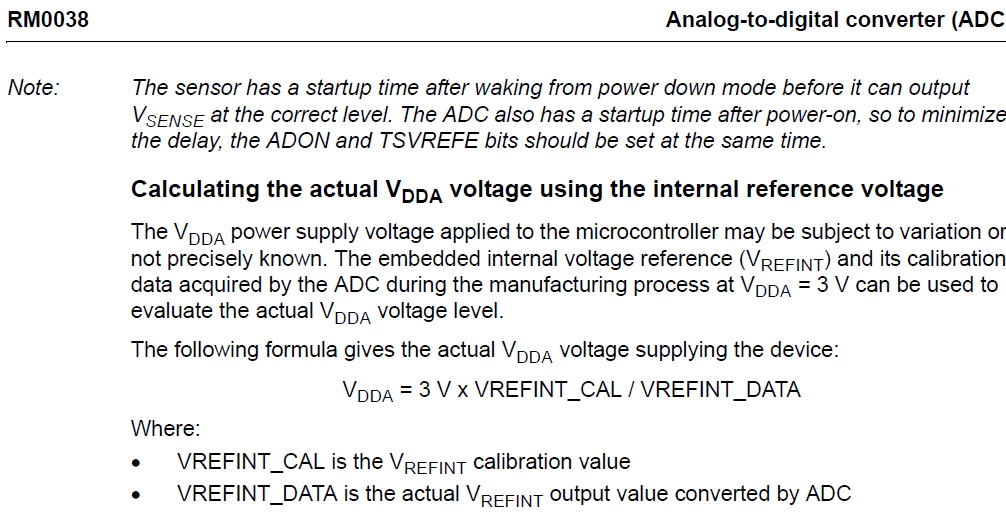

    >>> I use this function : HAL_ADC_GetValue(&VDD_measurement);
    This function gets converted value only.
    Also your ADC_SAMPLETIME_4CYCLES is small.  My suggestion is to increase it at least to ADC_SAMPLETIME_96CYCLES  and after you have a success reading try to calculate the exact timing.
    Try to use
    uint32_t vdda;
    #define VREFINT_CAL_ADDR ((uint16_t*) (0x1FF800F8U)) /* Internal voltage reference,
    #define VREFINT_CAL_VREF                   ( 3000U)                    /* Analog voltage reference
    HAL_ADC_Start(&VDD_measurement);
    vdda=VREFINT_CAL_VREF*(*VREFINT_CAL_ADDR);//VDDA = 3 V x VREFINT_CAL / VREFINT_DATA
    HAL_ADC_PollForConversion(&VDD_measurement, 1000);
    vdda /=HAL_ADC_GetValue(&VDD_measurement);
    The vdda value will be in millivolts.
    Use the same way to read the PA2  Start, Wait, Read.
