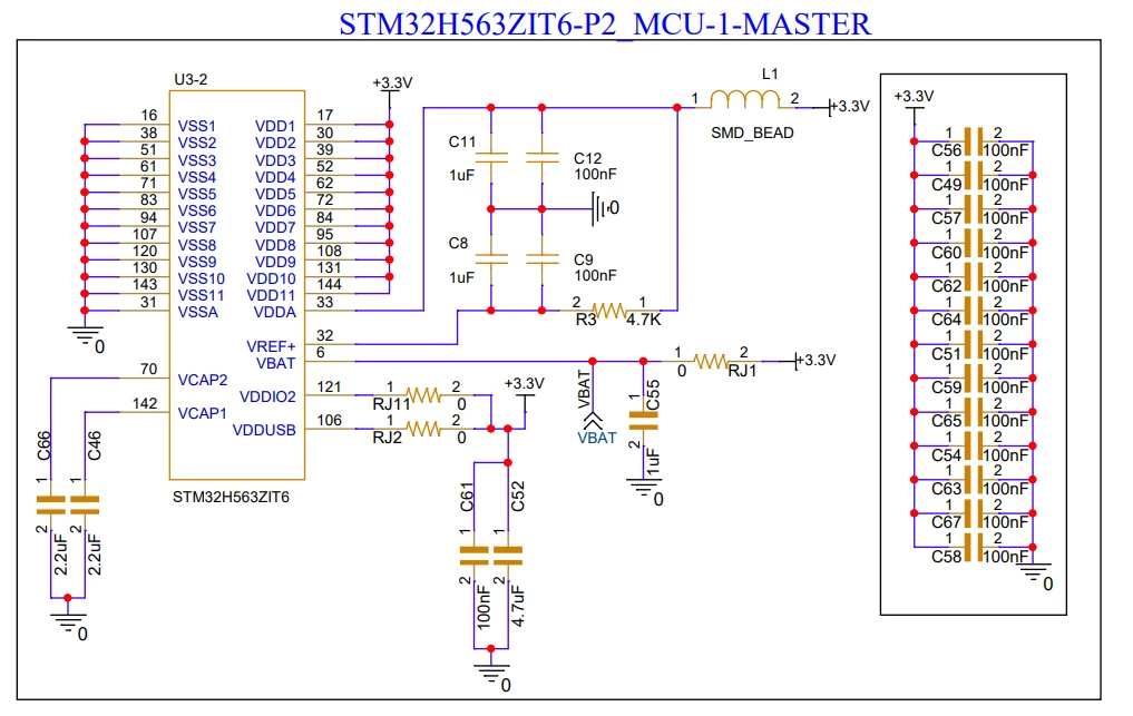

I am experiencing issues with the VBAT pin on the STM32H563ZIT6 microcontroller. Specifically, the VBAT pin is not responding properly. I am using a CR2032 CMOS battery for RTC backup, but it is not maintaining the date and time as expected. When the power supply is off, the RTC does not hold and run correctly, but it resumes running once the power supply is restored.
I have attached the circuit diagram for your reference. Could you please provide a clear explanation of the potential issues and offer guidance on how to resolve them? Expert advice on this matter would be greatly appreciated.

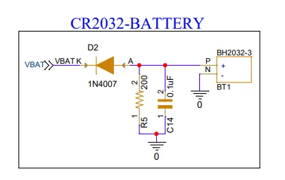

R5 is discharging the battery to GND with 15mA. That's a lot and I don't see a need for discharging a backup battery.
RJ1 is also discharging the battery by having the battery supply current to the entire circuit, it also prevents the circuit from powering off. Internally VBAT is bypassed when VCC is present, so you do not need VCC connected to VBAT at all. Remove these resistors. You don't need the diode, it just ads voltage drop. C14 is redundant because of C55 and it is behind a diode, you only need one, look at the guidelines for what capacitor value is recommended. Extra components potentially add a small leakage current.

As per your instructions, I have made the following changes:
  • Removed RJ1.
  • Cut the 3.3V supply.
  • Removed D2 IN4007 and replaced it with a 0-ohm resistor.
  • Removed R5 and C14 & C55.
  • Replaced the old CR2032 battery with a new one in the VBAT CMOS holder. Before replacement, I checked with a multimeter and confirmed the voltage is 3.3V.

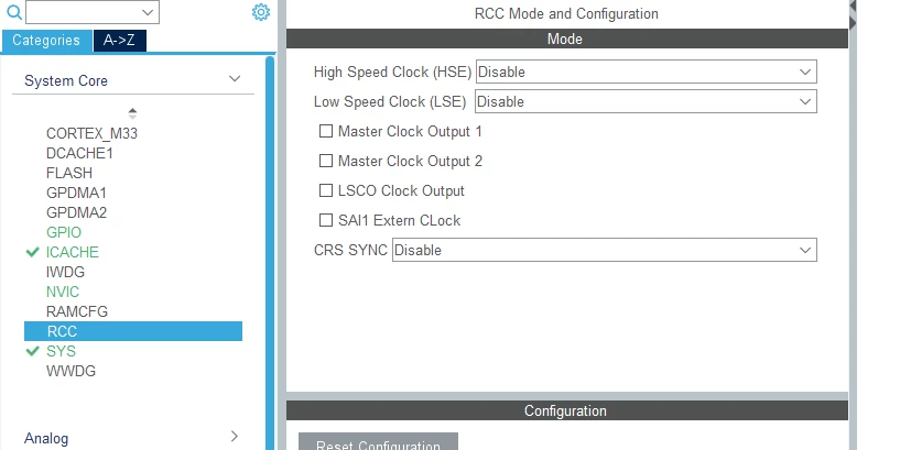

Please upload your .ioc-file so we can check your configuration.
"Kudo posts if you have the same problem and kudo replies if the solution works.Click ""Accept as Solution"" if a reply solved your problem. If no solution was posted please answer with your own."
unsigned_char_array
Lead III
June 22, 2024

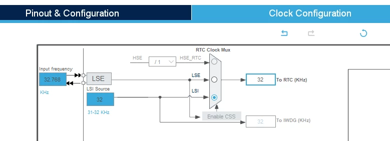

As I suspected LSE is disabled. So your crystal will never oscillate.
unsigned_char_array_1-1719042672605.pngAnd you don't use LSE as clock source either.

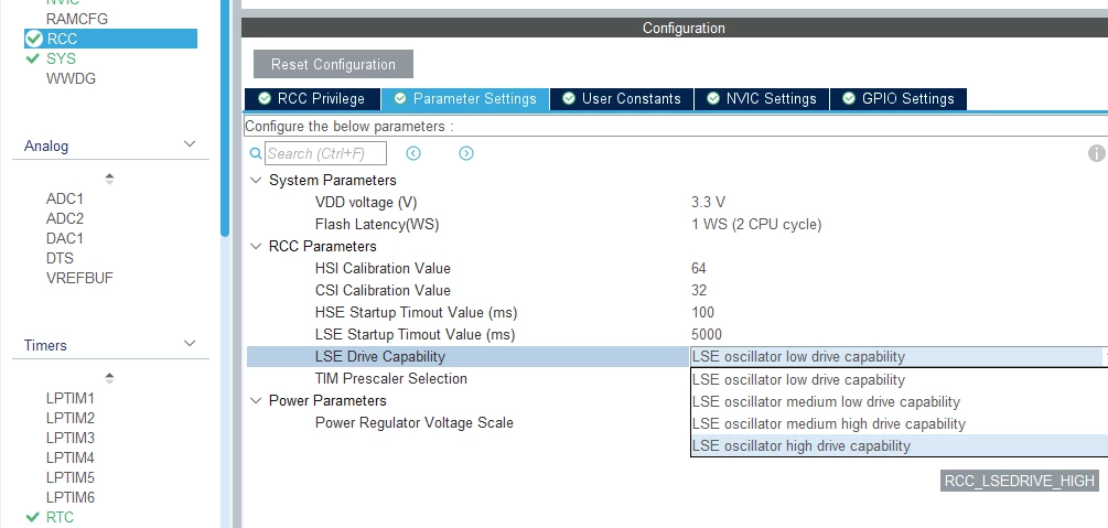

Drive strength depends on the MCU family and used crystal. Higher drive strength consumes more current. Too low and it may not oscillate.
Check Table 7. "Recommended crystal / MEMS resonators for the LSE oscillator in STM32"
from an2867-guidelines-for-oscillator-design-on-stm8afals-and-stm32-mcusmpus-stmicroelectronics.pdf for what your MCU supports.I've had issues with using a not supported crystal with too high capacitance. It resulted in some boards not booting sometimes since the LSE init function time out. The trick was using a different crystal with correctly calculated capacitors and set the right drive strength (in our case second highest level was good).
Check the datasheet of your MCU to see what drive strength levels are supported for LSEDRV.
"Table 43. Low-speed external user clock characteristic" in stm32h563zi.pdf
