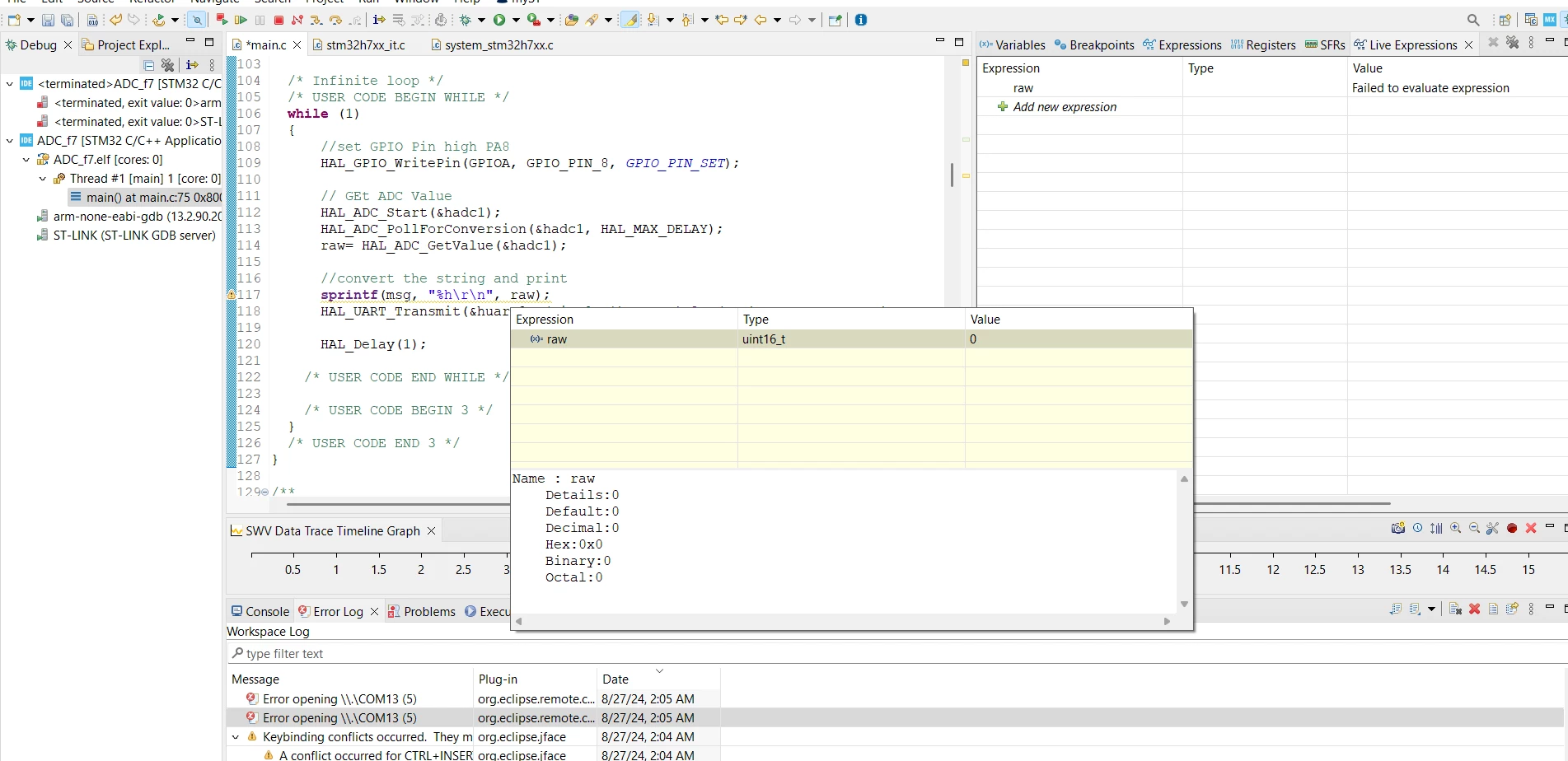

Hi Guys,
This is my simple ADC program and i was expecting to see some data output on Live expression window. Instead it is showing "Failed to evaluate"
//initialization:
/* USER CODE BEGIN 1 */
uint16_t raw;
char msg[10];
/* USER CODE END 1 */

The same issue is not happening when i am using Black pill board and all live expressions are visible.
So what board are you using when the issue does happen ?
Does the correct output appear from your UART ?

My board is Nucleo H7A3ZI 144 pin.

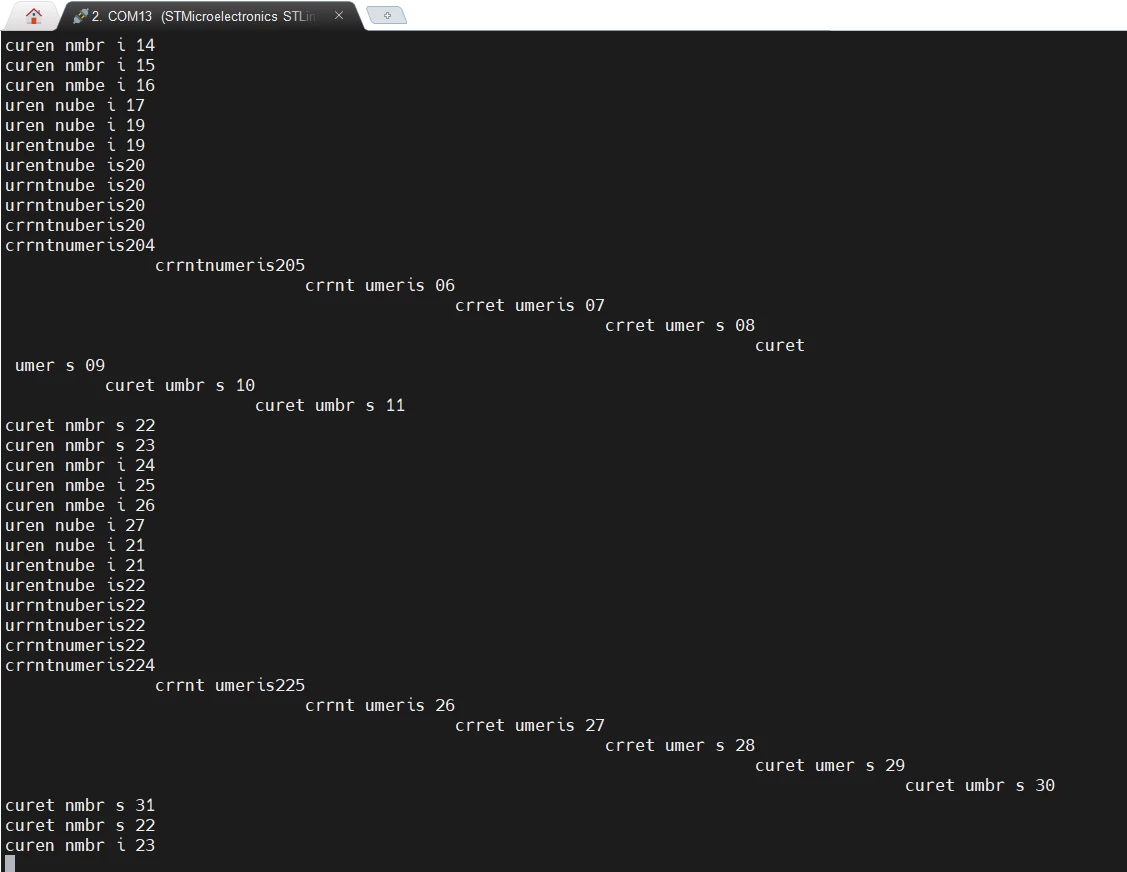

Regarding UART, output is appearing jumbled on Terminal (screen shot attached) .

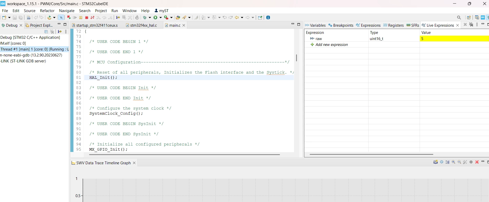

I am not able to evaluate any live expressions. While with same code i am able to see live expressions in my STM F4 black pill board. (screen shot attached).
So i belive, i am missing some setting of Nucleo H7A3ZI board and that is creating problem.
What is your opinion?

And try to declare raw variable as global.
mahmanishAuthor
August 27, 2024
This was too bad for me to see this mistake. I wasted so much time on this. Fianlly everything is in order.
