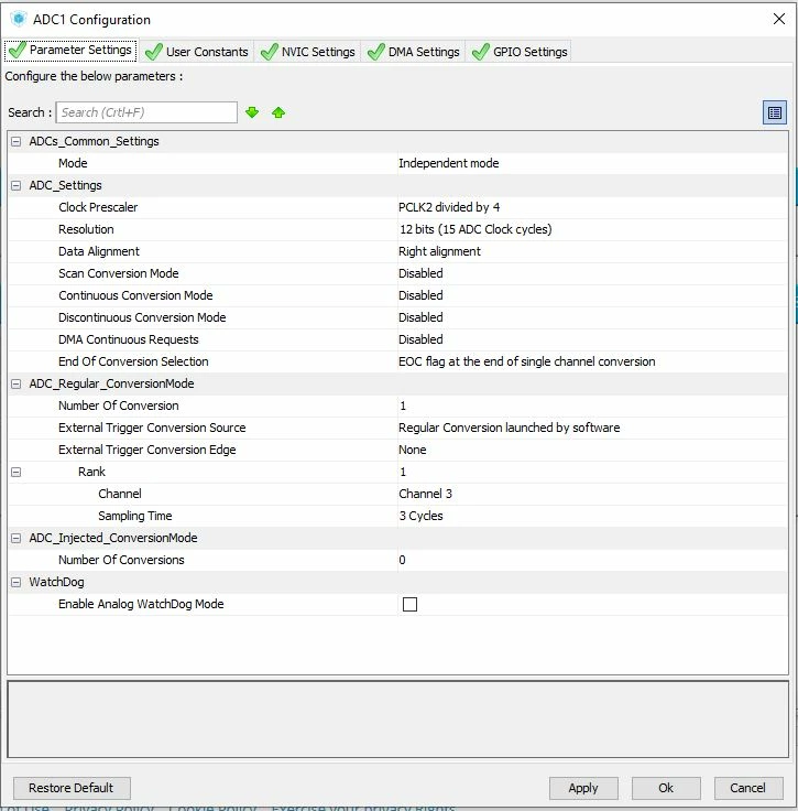

MReyn
MReynAuthor
March 8, 2020
Thank you for your reply,
i was able to view the exact value of the ADC, when i apply 3.3V the readout is correct. But when i apply 0V to the ADC input pin, the result shows 1023 and this should be zero. What can be the cause of the ADC reference drift? I again confirmed my input voltages and those were ok. When i apply around 0.4V to the inpu0693W0000000B3sQAE.jpgt pin the ADC already goes to 4095. Attached you can find my ADC settings
March 8, 2020
It is unlikely that you'll get a reading of 1023 if the pin is really at GND. The negative voltage reference is GND, and that doesn't drift relative to itself. I would recheck your assumptions.
What sample time are you using? Change it to the highest and try again.
Tips for general ADC accuracy can be found in AN2834.

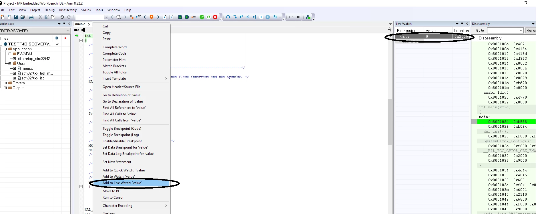

Imen GH
March 9, 2020
I have reproduced the case on my side and I don’t have any problem (when using ADC1_CH3 on PA3).
when I apply 0V to the ADC input pin, the obtained result is already 0, as shown in Figure (when using IAR).
In addition, I used a potentiometer in input and it can be confirmed that the obtained values vary between 0 and 4095.
Please find attached my file main.c .
