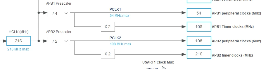

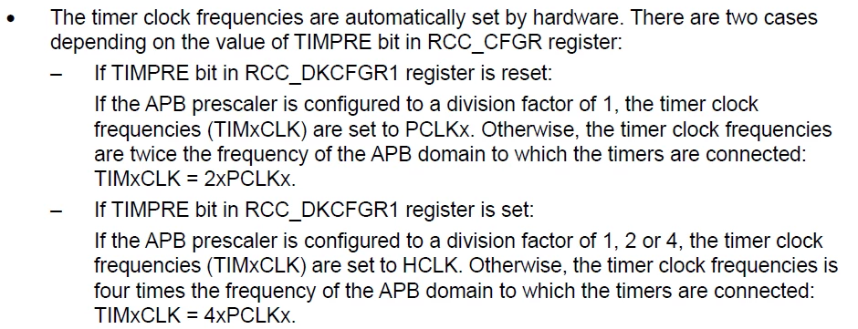

I have to update this thread.
The above code MIGHT work for other STM32 MCUs but it does NOT work for the STM32F7 in all cases:
In my case:
0693W000007ZQBhQAO.pngSince the APB1 Prescaler is not "/1" then the timers are actually running at 2x the PCKL1 frequency returned by the HAL_RCC_GetPCLK1Freq() function.
waclawek.jan
Feb 25, 2021 8:01 AM UTC
There's probably a dedicated incantation in Cube/HAL to determine the timers' clock. I don't Cube.
