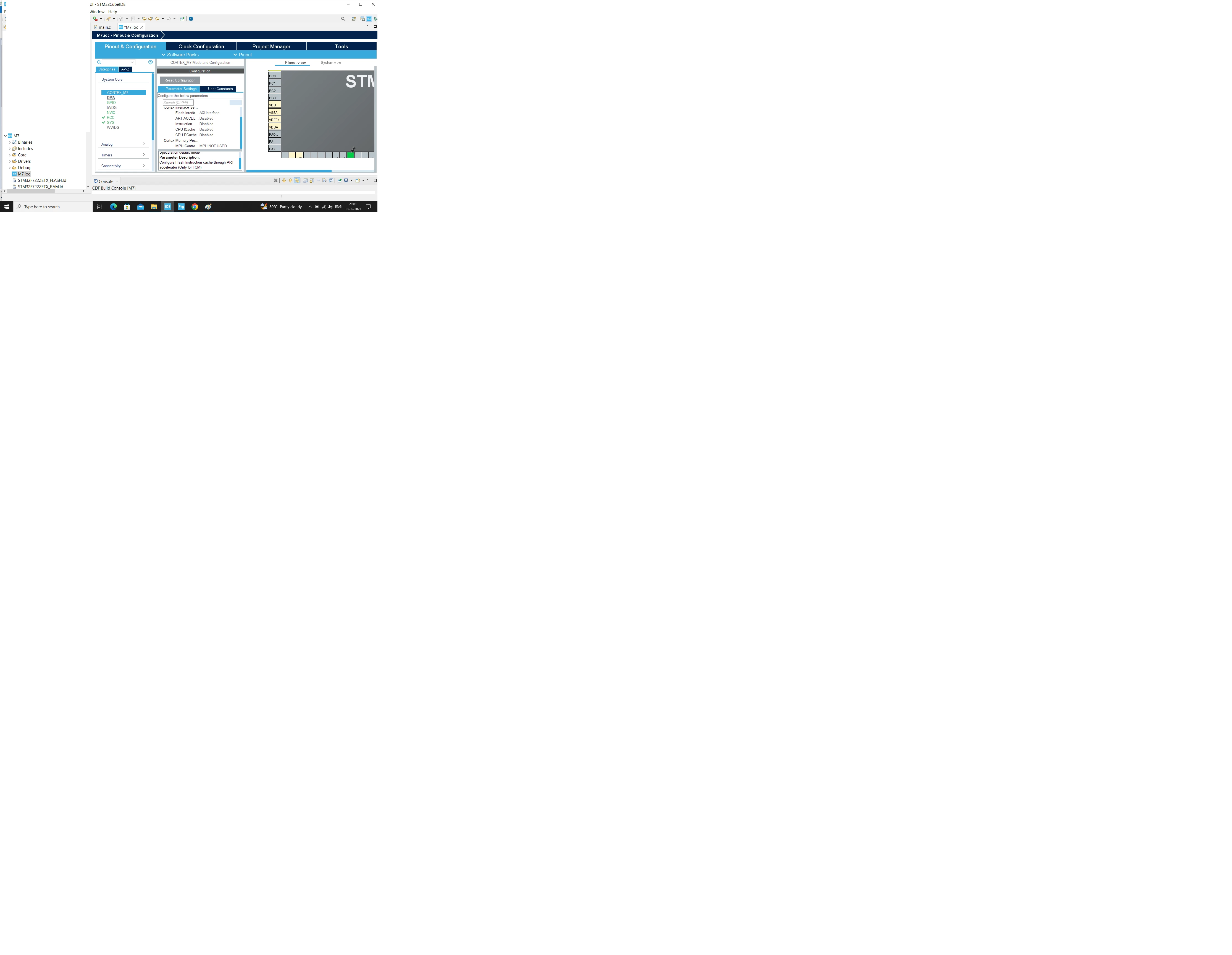

using the stm32f7222ze - nucleo board and trying to activate standby mode and wake up by pin PA0 .

the above code of standby activation and wakup from pin PA0 is working with stm32f103 series and stm32f411 series but not working with stm32f7222ze Nucleo board .

well . it's working if we uses __HAL_PWR_CLEAR_WAKEUP_FLAG(PWR_WAKEUP_PIN_FLAG4); instead of this __HAL_PWR_CLEAR_FLAG(PWR_FLAG_WU); we need to specify the pin flag

stm32f7222ze first time going to standby mode and once you give the wake up then it's keep on going to initializing and and waking up automatically . any one please suggest me about stm32f7222ze nucleo board stand by activation and wakeup

STM32Cube_FW_F7_V1.17.0\Projects\STM32F722ZE-Nucleo\Examples\PWR\PWR_CurrentConsumption\Src\main.c
