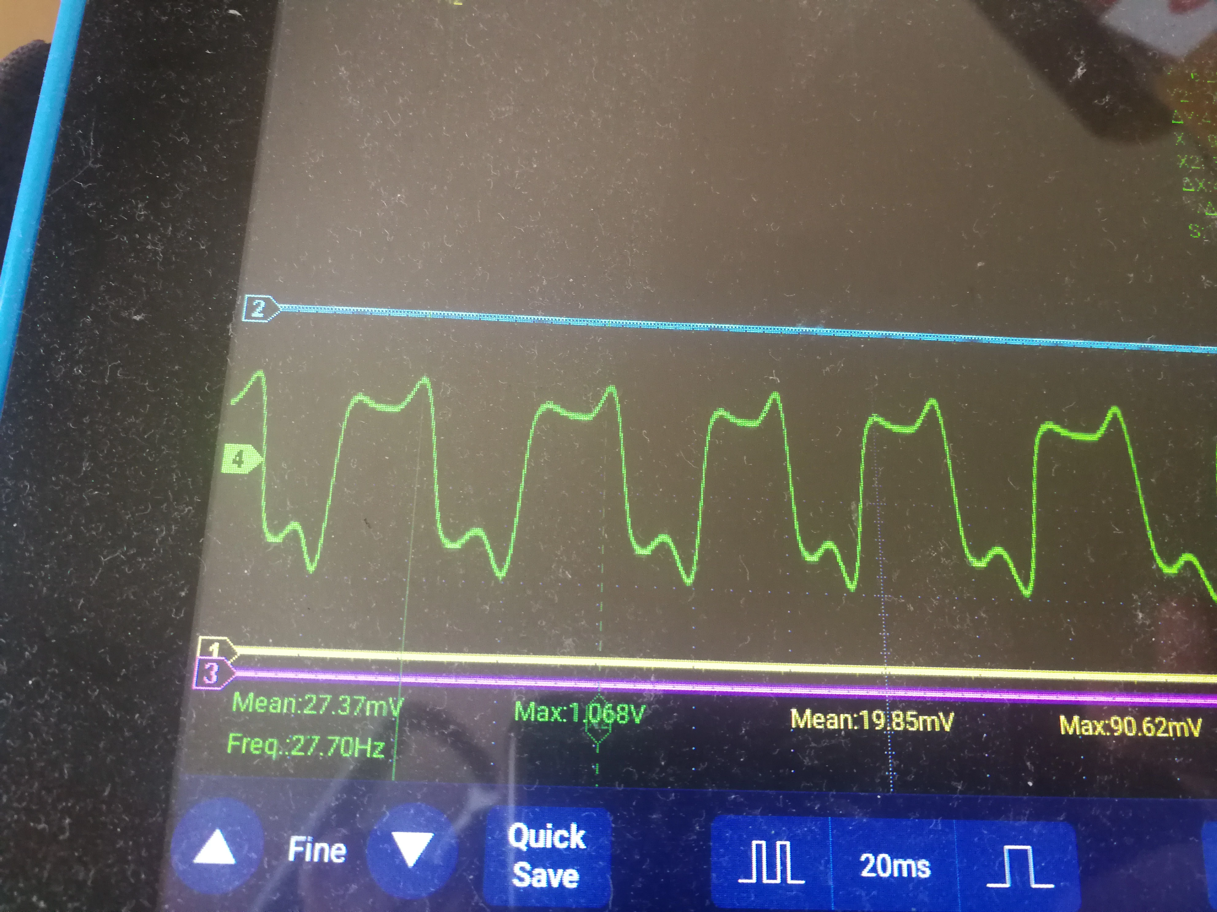

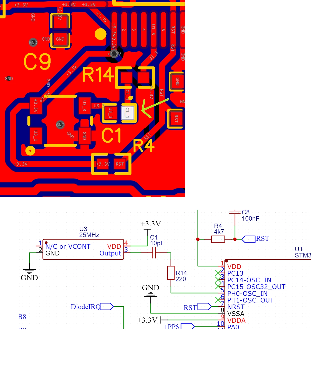

I would like to use TCXO (25 MHz) for timing STM32L071. It doesn't really work for me. When I put a scope probe behind C1, a signal can be seen in the picture. (some 27 Hz). Do you know what's wrong? The power supply for TCXO is 3.3
Please any idea? Thank you.

HEY you are right!!  That's surprising! I'm currently observing a 25 MHz signal with about 2 Vpp between C and R.
Just can not see MCO outpu on PA8... Set in CubeMx..
Read user manual to CubeMX (if exists), or set MCO by yourself without CubeMX... In LL API on STM32F0 it takes about three or four lines:
LL_AHB1_GRP1_EnableClock(LL_AHB1_GRP1_PERIPH_GPIOA); // Enable GPIOA clodk
LL_GPIO_SetPinMode(GPIOA,LL_GPIO_PIN_8,LL_GPIO_MODE_ALTERNATE); // Set PA8 to "alternate"
LL_GPIO_SetAFPin_8_15(GPIOA,LL_GPIO_PIN_8,LL_GPIO_AF_0); // select appropriate alternate function
LL_RCC_ConfigMCO(LL_RCC_MCO1SOURCE_SYSCLK,LL_RCC_MCO1_DIV_1); // select MCO source
By the way, what is purpose of C1 and R14 and how do you control DC voltage at PH0 input ?
