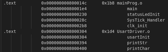

SBona.2
SBona.2Author
Apr 14, 2020 12:47 AM UTC
Here is what's inside systick handler:
void SysTick_Handler()
	counterVal += 1;
	GPIOA->ODR ^= GPIO_ODR_ODR_5;
If I set a break point on it, it does not reach it.
The stack pointer is at the top of my stack on the reset.
Here is the map file, and it appears the handler is at 0x0800028c:
Could this be the issue?
waclawek.jan
Apr 14, 2020 5:37 AM UTC
What's its value?
Okay, and how does the vector table (starting at 0x0800'0000) look like in disasm?

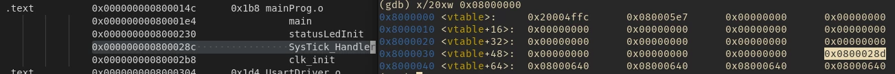

SBona.2
SBona.2Author
Apr 14, 2020 6:31 AM UTC
Actually I must've misread the stack pointer, it is nowhere near the top of the stack. It's at 0x20000f38, and the top of stack is 0x20004ffc. Which is odd considering all I'm doing before the systick exception is called is incrementing a value and printing text. I also noticed the LR is all F's, which is odd. I'm not sure of a circumstance that would happen. Here's a screenshot:
The vector table looks like this (note the address of SysTick_Handler is different because I changed some other code a bit:0693W000000Vkv0QAC.png
The vector table has 0x0800028d, and the address of SysTick is 0x0800028c. 0x28d seems reasonable considering I'm compiling with thumb, which does 16-bit instructions if I remember correctly.
berendi
Principal
Apr 14, 2020 7:00 AM UTC
PC=0x1FF00348 means that it is executing the ROM bootloader, not your program. This explains the odd SP value, according to AN2606 the ROM uses the first 4K of the internal SRAM, i.e. 0x20000000 to 0x20000FFF. The question is of course why did it enter the ROM bootloader?
The MCU has 80k of RAM, 0x20000000 to 0x20013FFF. Are you using some custom memory layout?
All fault handlers except Reset and Systick are empty in the vector table, why?
Lots of unusual stuff. What kind of toolchain is that? Where does your startup code and vector table come from?
