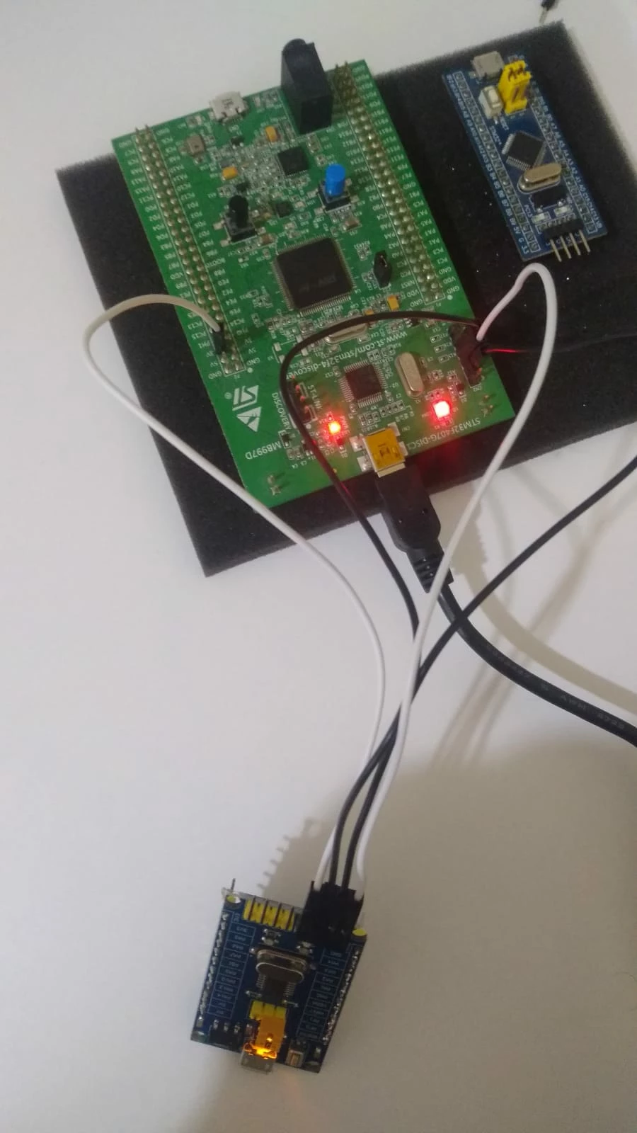

Using STM32F407VG Discovery Board's Debugger to debug STM32f0304P6
Hello. This is my first post here. I'm pretty unexperienced at the hardware side of MCU's and I want to debug my STM32F304P6 processor (on an unofficial board) through debugger of STM32F407VG Discovery Board. I connected SWD pins ( 2nd to CLK, 4th to DIO, GND to GND and 3v3 to 3.3V on Discovery) and unplugged CN3 headers. And I get can not find target error. Than I tried to connect 5th SWD pin with NRST on board but the result is same. I read the documentation and I don't know where am I doing wrong. Thanks
PS: I tried the same method with STM32F103 too. Result is same. Discovery board works well.
Unofficial STM32F034P6 Board:
EUygu.1
EUygu.1Best answer
Nov 9, 2020 8:39 PM UTC
Thanks for all the comments.
I connected BOOT0 to 3V3 STM32F03 to PC while reseting core by hand than wiped the system memory. Than took the BOOT0 to GND back and connected under system reset. Now it works well =)

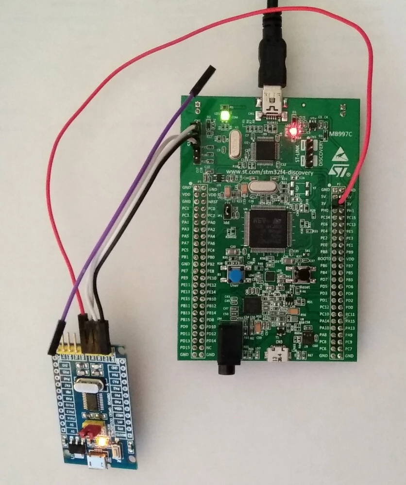

Nov 8, 2020 10:39 AM UTC
0693W000005AhubQAC.jpgWorks without trouble. The error appearing in the log is due to the 'blinky' firmware on the F030. Pressing the (Reset-) button on the F030-board cures this.
EUygu.1
EUygu.1Author
Nov 9, 2020 1:56 PM UTC
@Andreas Bolsch​ I did the same connections with you and tested on ST-Link Utility and STM32Cubeide by using ST Link GDB Server (sorry as I say 3.3 I mean 3 that's a terrible mistake). And having errors on both of them. I'm using latest debugger frimware on STM32 Debug+Mass Storage+VCP type. I tried on different clock speeds. Thanks for your respond
