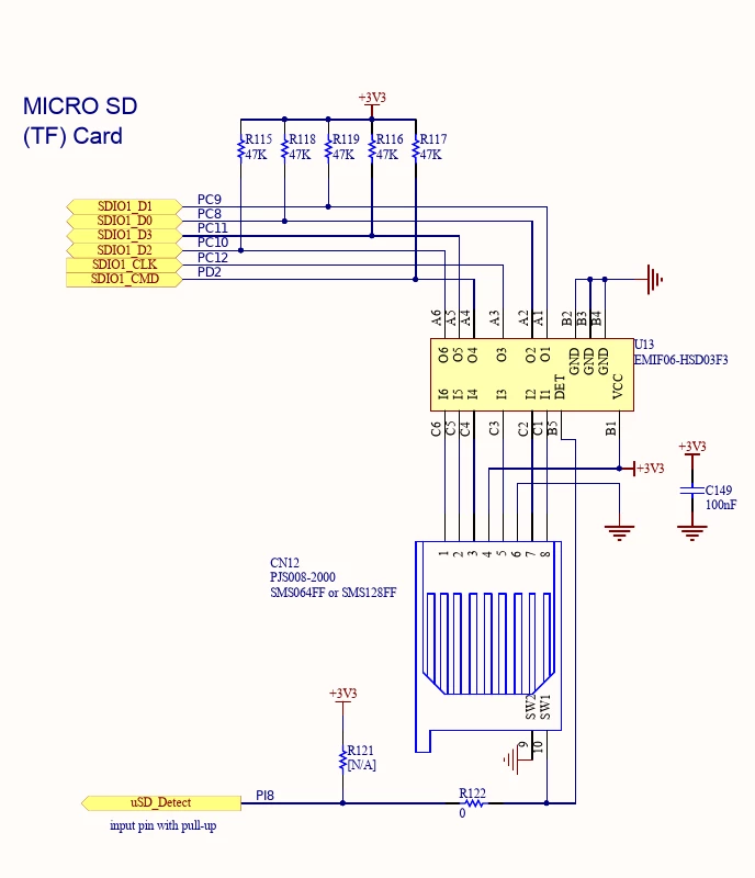

It's readable if you zoom in. Here's a description:
The top schematic:
CS - C11 through a 10K resistor
D1 - D2 through a 10K resistor
CLK - C12 through a 10K resistor
D0 - C8 through a 10K resistor
RSV1 - C9 through a 10K resistor
RSV2 - C10 through a 10K resistor
CD - E7 to 3.3V through a 4K7 resistor
WP - E8 to 3.3V through a 4K7 resistor
Bottom Schematic:
Dat0 - C8 through a 10K resistor
Dat1 - C9 through a 10K resistor
Dat2 - C10 through a 10K resistor
Dat3 - C11 through a 10K resistor
CMD - D2 through a 10K resistor
AScha.3
June 9, 2024
NO. Try zoom it from the pic here ... !
But now you wrote some values... ok, this cannot work.
10k series - how you came to this idea ??
Change all these series resistors to 33...51 ohm , then try again.
here example sd-card adapter (resolution as in your pic) :)
or from STM board (in resolution, as i use on my TFT :(
(The EMIF... you dont have, but here are your series resistors 33...51 ohm , or just without,  r=0 .)
